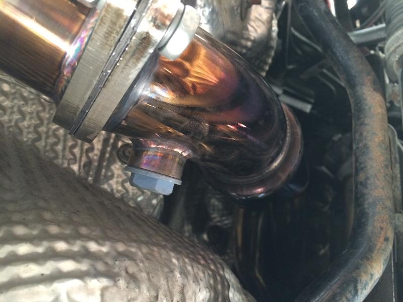

Hello guys!
I was wondering if anyone ran into this problem with the Megan headers. My 02 sensor that are on the headers is so close to the heat shield that I cannot plug my 02 sensor in. What can I do? Is it bad to run my car without it and only the 02 sensor on the cat?
-Paul

You have to run the 1st o2 sensor. That is a major sensor reading for the DME to make the engine run as it should. The 2nd o2 sensor does not do anything other than monitor the cat you no longer have. Looking at the header you clearly already ran it without it. I have no experience with that header but you need to go to an exhaust shop and have the o2 sensor bung moved.

I ran the car for about 10 blocks. So, I took the shield off, and it fits now, but I don't have a long enough 02 sensor since the sensor is placed way lower than the original place. Is is possible to buy a longer one? I just need a little more length. Also, is it bad to drive it a little bit? No freeway, just little city blocks.

I actually got the o2 sensor to fit! I had to take the o2 sensor harness off the socket and pull it closer towards the bung. There is a little pressure near the o2 harness because I had to bend it towards the bung, but it should be fine. There is still a little slack. It is not pulling against each other. What do you guys think?

The extension you would need is not a proprietary piece. It just needs to be for a Bosch O2.
If what you have now is working and you are satisfied with the slack available in the harness, you're good to go!
