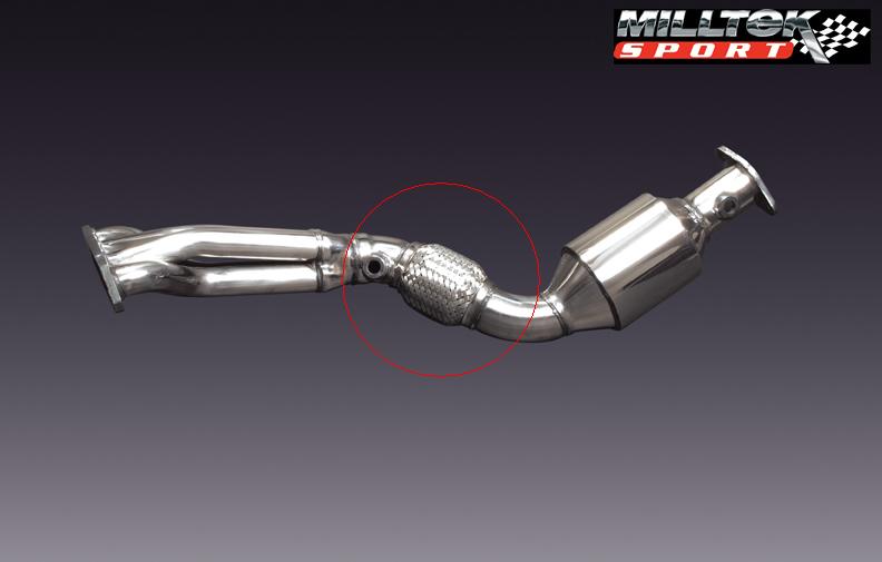

Old Dec 13, 2006 | 08:19 PM
harhoosh's Avatar
harhoosh
Joined: Oct 2006
Posts: 201
MY car is JCW 03
the sound is coming from here
check the attachment.. and tell me if it can be fixed or i have to replace it

You could have a new flex pipe welded on I guess... I'd just take this as a reason to go aftermarket...

There might be an OE header complete over in the Market Place, there was the other day. It could be fixed or you could post WTB.
To fix the problem some shops have the flex material ( flex joint ) Monroe comes to mind & they could weld a new piece.

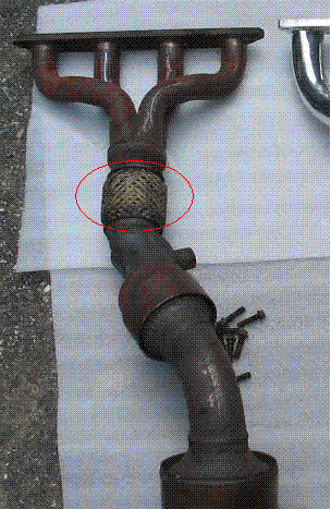

jst now i come from garage,,, they told me its the Flix pipe totally damged

Look To The Pic...
This Part Of My Headers Is Damged .... I Went To The Garage He Told Me I Can Fix It But Its Not Gurantee

No you should not drive the car with this kind of problem..
You should fix it. If the flex is replaced ( as a unit ) it should last for a while. At the least it will buy some time to purchase a performance header of your choice.
