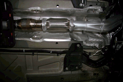

Dr. O: In general, most of the headers are shorter than you would build from a header tuning standpoint, but one works with the space available....
Most but not all! For those interested in a truly developed header I'll have one on the street by Wednesday. I spent the weekend with it at Pocono testing it. Pricing and specs will soon be released. Read about it on my web site.

Yes, there is news. See the web site for a picture and call for options and details. They are sized to fit your application.
Nice.
Doesn't look too street though. Long primaries are nice but the exit is going to leave you with a hacked up valance.
Do you need extra heat shielding with the cat being back under the seating area, does it come with extensions for the O2 sensors, does it fit older cars and about that valance, any plan?
I'm thinking these might be good general questions. I am not picking at what looks to be a nice system.
PS:
In this pic I don't see bungs or leads.

Those are some seriously long primaries (for a mini) and Stahl is reputable. It looks like a complete exhaust system though and current catbacks won't work with this longer header. Is this really the case?
Attached Thumbnails 4-1 vs 4-2-1 Headers-img4.gif   4-1 vs 4-2-1 Headers-img26.gif
Sounds like time to get the welder out....
Your right, its a full system. Current cat backs will not work.
You will need the entire system. Don't know if Don plans on selling the header cat and allow to splice it into an existing system. I doubt it. That would undermine the testing put into the design.

Some answers:
It is an entire system: header and cat back.
I'm not quite sure what "street tough" means.
I run it without the valance; one will be made and I'll offer it as an option.
You need to lengthen all 3 O2 sensors: Mini & optional wide band. It's easy.
You wouldn't want to change the basic design by fitting another system to it as it was designed to run the way it was built by Stahl.
Old Sep 25, 2006 | 03:31 PM
dmh's Avatar
dmh
Joined: Mar 2006
Posts: 1,135
From: Metro NY
Stahl Headers & CAT back
Stage 2 is currently being built. Pricing will follow shortly. It will be offered with 2 muffler choices: street and sport.
The sport mufflers are loud under hard acceleration but quiet under normal driving conditions. Interestingly, when the mufflers warm up, they quiet down.
At the drivers seat, windows up:
low 70s db at idle
low 80s db on the highway
around 99db under hard acceleration
