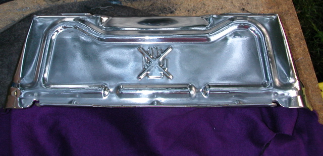

It's a tray for serving after dinner mints.
Did I win?
