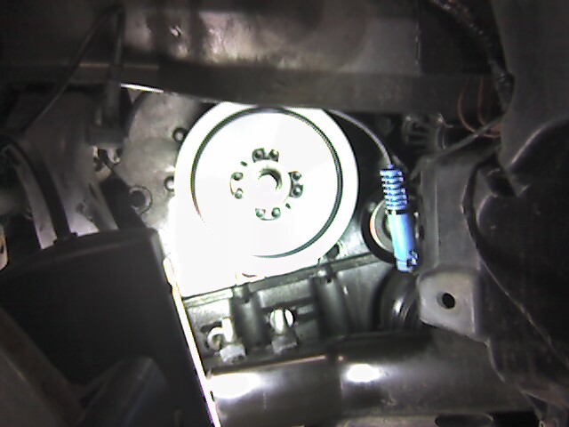

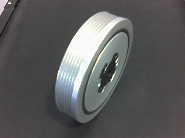

This should satisfy almost everyone
Instead of a "no" weight pulley, I just went ahead with a 4% larger, lightened (about 50%) true harmonic balancer that was originally developed by Mercedes. Because it is a clutch type ( there are weights on the inside), it was very noticeable how much smoother the engine ran at idle.
Attached Thumbnails DINAN says NO to crank pulley-photo_081205_002.jpg   DINAN says NO to crank pulley-photo_081205_004.jpg   DINAN says NO to crank pulley-photo_081205_011.jpg
50% of the '02-'04 or '05-'06 crank pulley?
Where do I get one and how much is it going to put me out? Are there any other sizes?
A fellow Mini enthusiast and engineer, Bob Townsend, is selling these. There are about 20 or so currently on cars in the Chicago area. They are not inexpensive – $495. This is one of the reasons Mercedes is not using this design anymore.
Bob can be reached at 630-742-1200. He can also tell you what the weight difference is compared to the 02-04 pulley. My memory may need a little correction in this regard.
It is only being produced in a 4%.

Originally Posted by dairyboy
Is that an off the shelf Merc parts or something knocked up by Bob?
They are being produced out in California by a firm that took over the production of the piece. Something about Mercedes selling them the rights.
I can't remember the name of the firm. Bob can fill you in.
