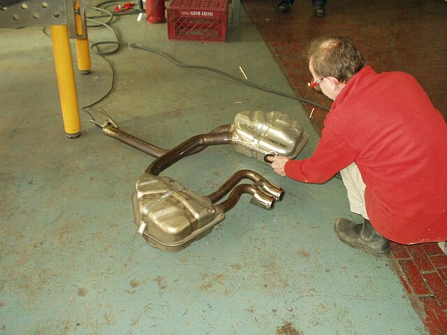

6.5mb (right click save as)
http://www.users.on.net/~rasper/video/one_ball.avi
AFAIK this is the stock exhaust, bar the elbow joint, no replacement of the piping from the cat back to the elbow. (It was on a friend's car, not my own.)

mind you i didnt replace the plumbing from cat back, only cut out the second ball and re-routed the plumbing to the single muffler using one small c bend

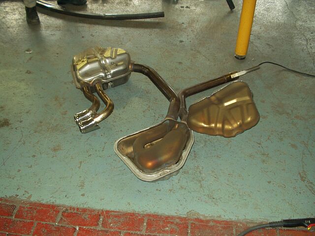

The semi-castrated portion is simply a glasspack bent in an interesting shape:

And in the photo [that I deleted] you can also notice that the connecting pipe between the huevos is larger [2-1/2"] than the upstream [2-1/4"] tubing...
-B

Look at the 'before' and 'after' photos in my photo gallery for clarification.
-Barry

So, by that response, I'm guessing the resonator is the piece you cut out on the passenger side that looks like a muffler? I guess I thought resonators were tube-like features closer to the front of the car -- is that only on the after market exhausts?
