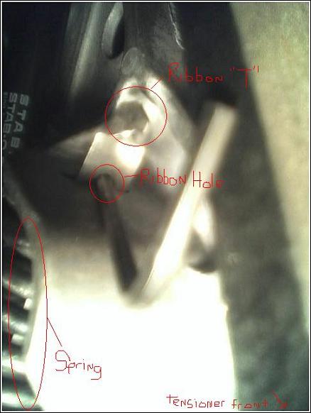

I was struggling with how to get the tensioner back on w/o a tool when I noticed a thin ribbon of metal running the length of the spring that came to a T on the top of the spring keeping it somewhat compressed. If you compress the spring with the tensioner on the ground you will notice a small hole that becomes visable on the thin metal robbon. Have a friend/wife/neighbor/stranger slide a small allen wrench in this hole (long side inserted, short side facing the front of the tensioner) and the spring will stay compressed. Then just reinsert the tensioner and put your belt in place with no hastle. Once all bolts are in and tightened grab onto the allen and give it a yank. The belt is the perfect tension, and you saved yourself $60.

Not having to downshift at all to pass on the freeway is nice.I added the pic I took w/ my cell, excuse the bad Microsoft Paint diagram...its all I have at work.
I have this theory that this is how they do it at the factory. I cant imagine any other reason that hole would be in the metal ribbon, and it seemed like there was a pin that had been in the hole before, and made a mark on the tensioner casting (it was really early, so dont quote me on that), which led me to the idea in the first place.
