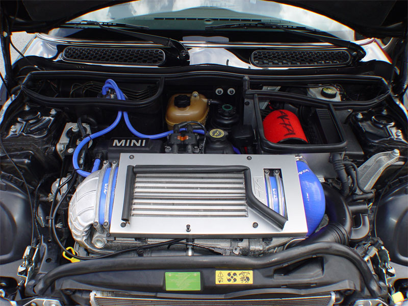

OCC & CAI install issues
Alta,
I installed the catch can and intake on Saturday. My SES light came on Monday... I hoped it wasn't because of my mods. I checked the gas cap since I filled up on Sunday. The light went out Tuesday afternoon and came back on Wednesday, so I'm eliminating the gas cap theory.
I've notice idle is a bit rough it ranges from 800-1500 RPM and usually sits around 1200 at a stop light (seems high to me).
If I had to guess, I would say it has something to do with the catch can installation...I consider myself fairly competent when it comes to such installations, but mistakes happen. The instructions mentioned alternate installation methods, but I only received 2002 instructions (I have a 2003). I ended up locating the CC near the DSC box (see pic). I know others have done this, so I don't think the location is the problem. I did notice that the hose had to turn a tight corner under the IC coming off the crank case hose. I tried to leave a little extra slack there to prevent the hose from crimping, but it may be doing this anyway.
Any thoughts as to what could be causing these issues? Thanks in advance!!

Old Jun 9, 2005 | 11:12 AM

Originally Posted by Pir8 97
Alta,

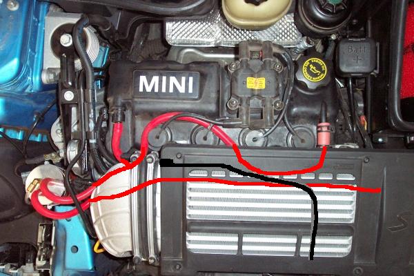

I have had mine installed for over a year with no problems. This is how I have mine installed.....
Notice I have capped off the grey SC hose.
Old Jun 9, 2005 | 11:29 AM

You really should have the DTC code scanned and see what the real problem is, but my guess is that you have a vacuum/boost leak at one of the intercooler boots. They're sometimes a beeyatch to get back on just right. If I were you I would pull the I/C back off and replace it, carefully checking to make sure that the boots were fully seated on both sides, and not pinched or kinked.
I'm not sure that having the catch can hose kinked would cause a SES light -- let us know what the DTC code is if you can get it scanned.
That's exactly how I have my hoses. I actually printed off your picture when I was installing
I'm well over 100 miles from a dealer/service center, so I want to try to figure it out myself first. I'll pull the IC tonight and take a look. I can see how this could be a problem.
One other thing I noticed today is the idle is much better (800-900RPM) when I have my AC on.

BigBrownDog is right, we can guess all day long, but knowing the code will tell us in seconds what is wrong. I too don't belive the kinked hoses matter at all.
I would guess some electrical connection was loosened on accident. Let us know what code you get and we can go from there.

I pulled the IC off and remounted it. I haven't taken it on the highway but I did do a spin around the building then let it idle... smooth as silk. We'll see if the SES goes off in a day or so.
Edit: The SES light went off on the way home last night! Woohoo!
