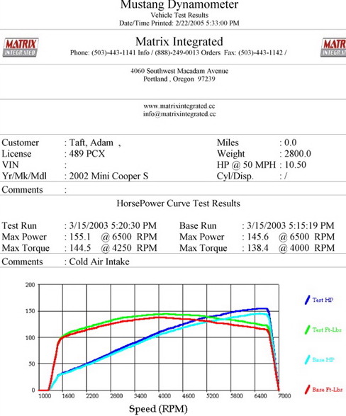

It is hard to say what milage you should clean the filter. Things like the climate, dusty, stuff like that effect how dirty the filter gets. As a general rule, i would say clean it every 10k miles. Here is the graph.
Notice peak HP was 10WHP more, and torque was 6FT/lbs more. The midrange gained 12-14WHP and 10ft/lb. This has been very repeatable amonst other people that have dynoed their car. This is also on a Mustand Dyno which reads low numbers. Dynos like dyno jet will see more than this.

I have a question on that graph - please correct me if I'm wrong.
The base run was done at 5:15:19 pm and the modified run was done at 5:20:30 pm.
So you removed the old intake system and installed the entire CAI in 5 minutes?
Or were both runs made with the CAI in place? If so, what are the hp/torque figures from the original intake system?

We preped the stock intake on the car to make the swap easier. Basically we remove the screws that hold the wall in place under the air box, and on the side, installed hose clamps on the tubes (so we could remove them easily) and as soon as the 3 base run was done we installed ours. With the correct tools in place the intake can be installed in about .5 hours starting from scratch. It really was pretty simple disconnecting the hose from the TB and removing the ECU/air box, then dropping in our filter/shroud/intake tube. This also makes the test very accurate doing it so quick.
This same day we installed our panel filter and got roughly 2-3 WHP and 2-3 Ft/lbs. Not huge, but some decent gain. Notice how long ago this was. To date their is no other intake out there that claim the HP and Torque we do.
