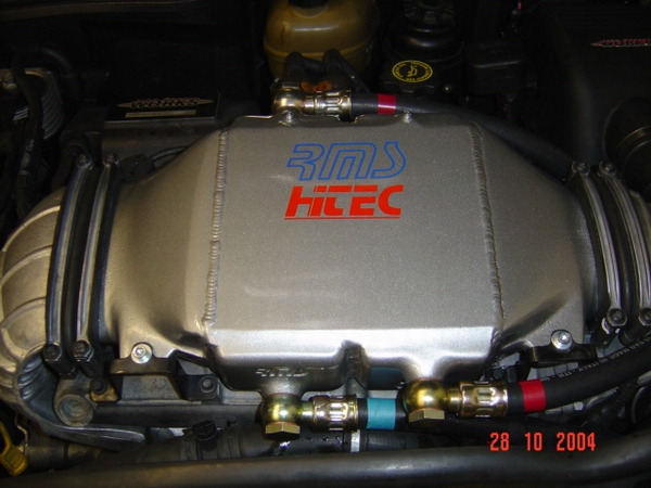

Originally Posted by jlm
there are two gradients at right angles:
the combustion air gets cooler left to right. and the water gets hotter front to back (assuming the water supply side is front. )
One is from the front the other from the back.
Alex

What jlm is saying is that the air is getting cooler as it travels down the length, and the water is getting warmer as it travel across the width.

Yes, there is benefit to the coldest water acting on the hottest air. But in this application, its not uniform across the hottest air. Its uniform across the front or bottom of the intercooler so the air that takes the lower path gets the majority of the cool coolant. The air on the top always sees warmer temp coolant. So what gets spit out isnt homogenous or efficient.
Maybe having one inlet and one outlet per side would lessen these less than optimal gradients. I think the pic in AlexN's post is showing this (red/blue markers)

Looks like very nice end tank casting though.

Regardless of the theory discussion, it does look really nice. Especially the silver one shown above. I will be interested in the numbers when they come out.
