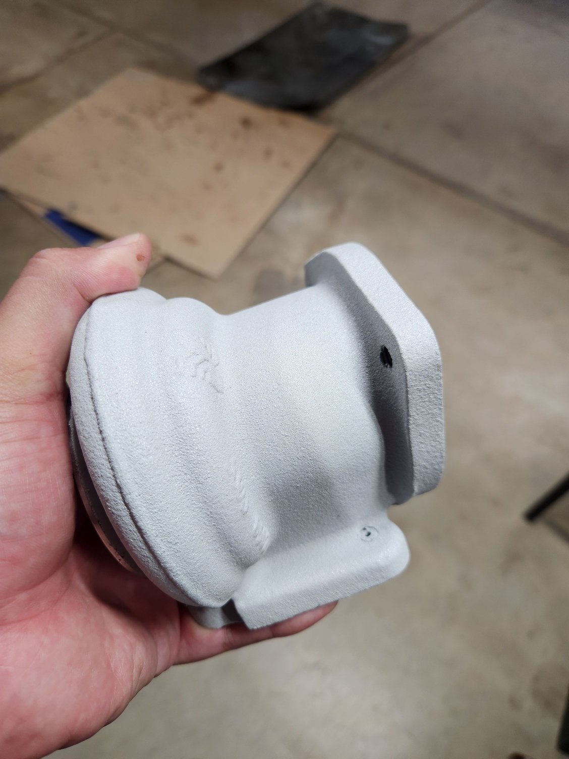

Here are my coatings when I got them new
oh my!!!!!!!

Just an update on my Swaintech coating. I have seen temps about 100-125 degrees cooler than my noncoated housing. This was gathered from my daily commute of about 30 minutes. Also doing some bigger pulls and checking temps
