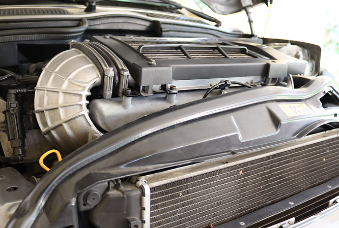

The OE unit is an aluminum casted manifold. Casted parts need to have a thickness of at least 5 mm. The OE manifold in the r53 MINI is not an exception with it's thickness varies between 6mm and 8mm!
The TPE Precision version is redesigned with a maximum plenum thickness of just 3mm. Thus
the internal volume is increased, without changing the outside dimensions.

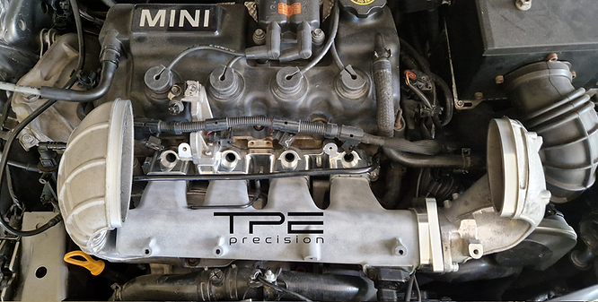

Version 1 (fully 3d printed):
Working prototype on the photo above vs the original unit.
The organic shapes help with the overall stability of the part. They look kind of nice, but I removed them in later revisions, as it was a pain to install the manifold, due to space limitations.
Exactly as the original unit
Plug and play.

Extra photos of the manifold:
Fully printed manifold.
Hybrid version. *The inside is the same in all versions.
Early working prototype.
Revision 19. This is how the part is, when it is removed from the printer.
First cleaning station.
Revision 19. Cleaned and ready to put the small metal inserts.
