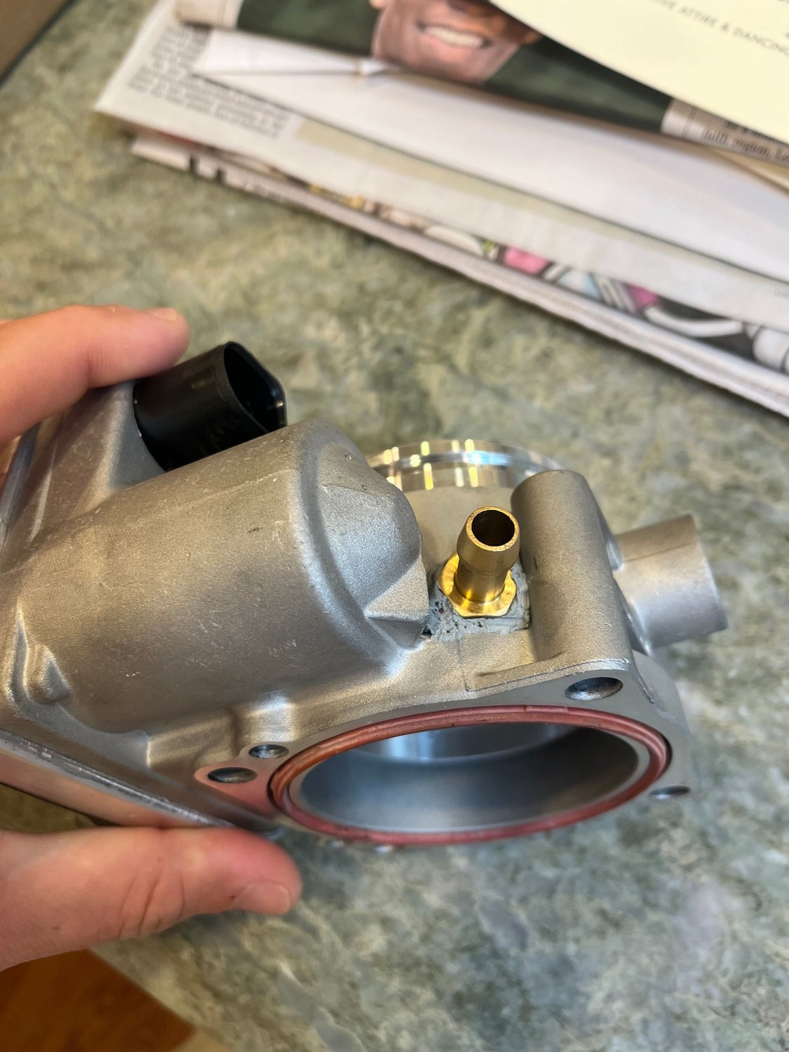

Originally Posted by daviday
Little update..
I tapped the vac line but was still getting P1498. Swapped smaller original TB back in and all good. No CEL and to be honest, the throttle feels much more linear. I think my experience with this was a tuning issue.
I didn’t do as nice/smooth of a job with the tap as I’d of liked though. Not sure if this could be the issue. Nicked the valve flap with the drill bit too.
Maybe the knick caused abit of air to get by ?
and it looks kinda loose around your barb.. when I'd installed my barb i coukd feel it bitting through tge aluminum throttlebody and i put a dab of 2x part expoxy on its threads too juuuuuat encase..but ither than that it looks ok..they often do require fine tuning though most can get by and still get gains with simply just bolting it on.

I definitely did not use the most appropriate fitting and ending up making the hole a tad too big. Ended up using a bit of plumbers putty to make sure it was sealed. I don’t think the nicks I made with the drill are causing any air to pass by but perhaps they’re affecting the flow. I still can’t imagine that being the cause of a vacuum leak code and the EML light coming on though.
I also don’t understand the difference in the throttle feel and response. I don’t know if I’m describing it correctly but it doesn’t feel right with the larger TB.
the difference in feel comes into play because of the larger throttle blade..if your tuning isn't correct for the big tbody it will feel " odd " you could say... I have to figure how to word this correctly.
but the stock tbody open say 10% and allows 10% air through and you ecu is set to detect that amount of air ect according to the amount you depress the throttle pedal. NOW if you just throw on a larger tbody untuned you go and give it 10% throttle and now your car is sucking in 15-20% air so for the same amount of throttle input your now seeing more engine response and flow but yet at the same % of throttle input.. so the more you depress the throttle the more inaccurate those readings can get and then the ecu doesnt know how to deal with all the extra air its ingesting at the programmed throttle input.. it all can be taken care of via tuning. And then everyone is going to prefer their pedal response and amount to depress it inorder to reach wot will be different.. imo I like how the stock tbody feels , it's very linear and with a larger tbody even when tuned correct your going to loose the ability to easier control the " yoyo" effect at low speeds because of the larger blade allowing so much more air passed. Unfortunately that's just the nature if the beast. Buuuuut you absolutely DO get more power and tq all around using a bmw 65mm tbody IF you have the corresponding mods.. imo if your running a 15% pulley and just exhaust, this mod is not for you.. once you've gone into more boost, larger intercooler, more fueling. Only after all that will you actually see the gains and benefits of a larger tbody... just because it makes more power on someone else's car does mean it will on yours. Prior modification absolutely will play a HUGE role in how these throttlebodies will respond on your vehicle. Trust me , if you only have minor bolt on modifications , don't bother with a larger tbody until much further down the mod list.. in all honesty it should be closer to one of the last modifications you do , then when you do tune you get it tuned in perfectly to accommodate your cars spefic air flow.. not some preset parameters that worked good on someone else's setup..
that's just my 2cents..
