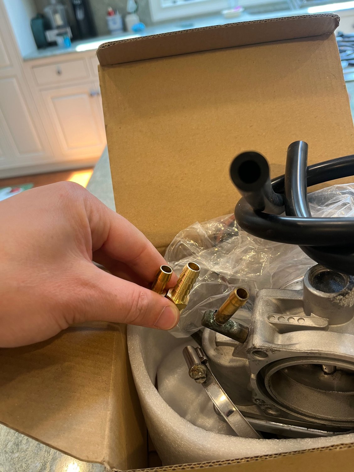

This is embarrassing but annual emissions inspection is at the the end of the month and I never got this fully sorted...still getting an EML light occasionally. Runs fine otherwise.
I never tapped a vacuum line for the larger TB and this doesn't look right to me. The hole I'd need to make in the TB for either of these seems like it would be much larger than it needs to be. What am I missing here? Are either of these fittings appropriate? Tia.

I tapped the vac line but was still getting P1498. Swapped smaller original TB back in and all good. No CEL and to be honest, the throttle feels much more linear. I think my experience with this was a tuning issue.
I didn’t do as nice/smooth of a job with the tap as I’d of liked though. Not sure if this could be the issue. Nicked the valve flap with the drill bit too.
