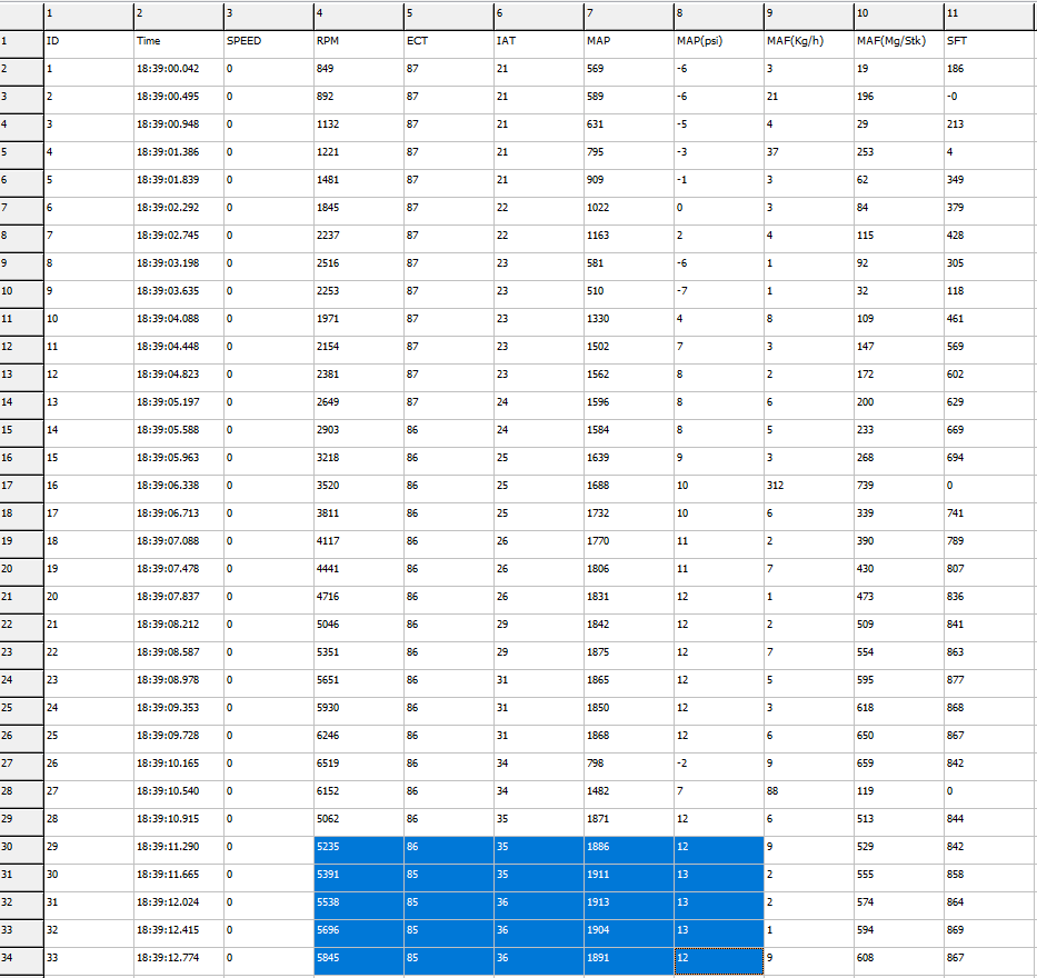

Hi guys!! I´m currently doing a custom tune, and doing some logs on the road, and we think the car has a boost leak because we are only seeing 11.5 PSI of MAPpsi at 5000RPM, are these normal values for my mods?
-SparkPlugs NGK Iridium BKR7EIX
-Panel K&N Filter
-Intercooler GRS Black
-17% SC Pulley
- Stock Head
-Cam Newman PH2 250/400 (I believe its also known as RMW Dominator CAM)
-Injectors Bosch 550cc
-Stock headers with both stock pre-cat and cat
-CatBack 63.5mm Direnza non resonated
I would really like to know what kind of values are you guys doing with similar mods before starting the search for some kind of boost leak or belt slipping.
Thank you so much, any help is appreciated.

Old May 16, 2020 | 06:48 AM
Da_Ghost's Avatar
Da_Ghost
Posts: 880
Likes: 56
From: Québec, Canada
The GRS intercooler alone probably shrink the psi numbers a bit since it's much larger than stock and the supercharger push the same amount of air, but has to fill more space.
Old May 16, 2020 | 07:10 AM
Juve's Avatar
Juve
Joined: Oct 2019
Posts: 40
Hi Ghost, ty for the reply, thats what i thought but even with the IC shouldn´t it be a little closer to 14ish psi?
Old May 16, 2020 | 11:24 PM
OCR's Avatar
OCR
Joined: Mar 2018
Posts: 795
Likes: 122
From: SoCal
Yea, don't agree DaGhost.
While the larger volume of the cooler will cause a slightly longer time to "get"...to pressure, the engine is still the plug and with a "plug" in the system, full pressure should still be achieved at a given rpm.
Like I say, it may just take a second or so longer to get full pressure. I'd still expect at least 12+ / 13 lbs. with that intercooler.
But I do not know about the cam spec's. If the new cam's duration or overlap is longer than the stock cams spec's...THAT will cause the pressure to be low.
Mike
Old May 17, 2020 | 03:00 AM
Eurothrasher's Avatar
Eurothrasher
iTrader: (10)
Posts: 1,864
Likes: 169
From: New England
If its this intercooler, no these boost levels not normal. These top mounted intercoolers like most aftermarket and DFIC style its more of an issue of not being able to direct the air flow as well as stock, and recovery time after heat soak.
Thats a significan boost loss.
I have similar mods sans the cam and pushing 17-18lbs all day.
I would use a quick tie to secure the BPV in a closed position.
Then see what happens....

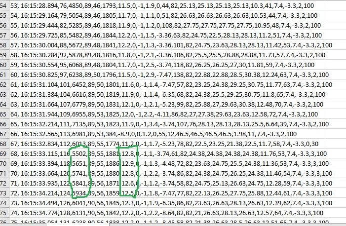

Old Feb 19, 2021 | 11:24 AM
Juve's Avatar
Juve
Joined: Oct 2019
Posts: 40
Hi guys, I´m sorry for digging up my own thread again.
But i´m yet to solve this problem!
Today I installed a detroit tuned BPV, I gained about 0.5 PSI across the rev range but unfortunatly the problem continues.
I get Peak Boost (13.4PSI) at 5600RPM and then the boost goes down to 12.3 and stays there till the rev limiter.
I dont know where to find the missing boost, with a 17% pulley i should be pushing 16 PSI.
Any ideas where to turn to next?
Already did belt, tensioner, BPV, IC Boots.
Any help is apreciated
As you can see after 5600RPM where I hit 13.5PSI the it drops to 12.4 and stays about there till the end
Old Feb 19, 2021 | 12:01 PM
Eurothrasher
iTrader: (10)
Posts: 1,864
Likes: 169
From: New England
Even with a semi-agressive cam I would expect some boost loss due the efficiency of the air flow with the Newman Cam you put in, and even more with a free flow cat/header. What sort of HP/TQ numbers are you seeing.
Old Feb 19, 2021 | 12:13 PM
Juve's Avatar
Juve
Joined: Oct 2019
Posts: 40
Haven't dynoed it yet, but should be around 230
Old Feb 19, 2021 | 01:10 PM
Eurothrasher
iTrader: (10)
Posts: 1,864
Likes: 169
From: New England
At idle is the boost gauge reading a steady 18-20inHg ?
If so I'm going with what you are seeing for lower boost is due to your air pump ( engine ) flowing air more efficiently reducing back pressure to the forced induction unit ( supercharger )
Old Feb 19, 2021 | 01:19 PM
Juve's Avatar
Juve
Joined: Oct 2019
Posts: 40
At idle im reading steady 16-17inHG
Yeah i agree that that is a factor but shouldn´t the boost increase all the way up till the rev lim?
Should it be peaking at 5500rpm?
Old Feb 19, 2021 | 02:25 PM
Eurothrasher
iTrader: (10)
Posts: 1,864
Likes: 169
From: New England
No your right, boost should probably continue to climb up to 6500 or 7000 depending on your tune setting.
And that low at idle I'm thinking maybe boost leak as that is a good way to gauge that....maybe cracked line for the FPR from right side of horn ? My last boost leak I found to be missing metal gasket at left side supercharger horn....
Who did your tune ?
Bytetronik has some experience with modded R53's, Bytetronik maybe he can chime in.
Old Feb 19, 2021 | 02:34 PM
Juve's Avatar
Juve
Joined: Oct 2019
Posts: 40
Who did your tune ?
I'll Check the FPR lines!
Adrian CL tuned my car
