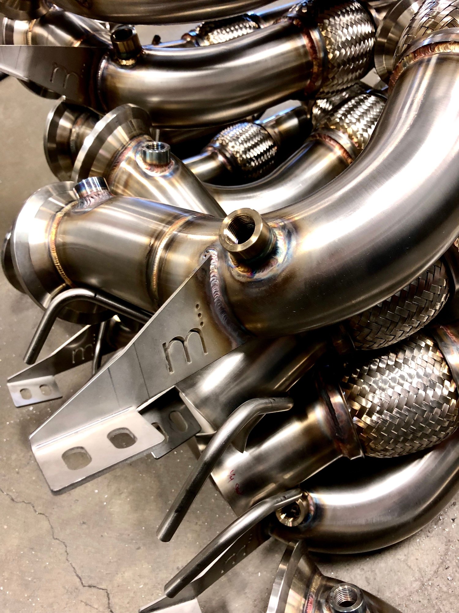

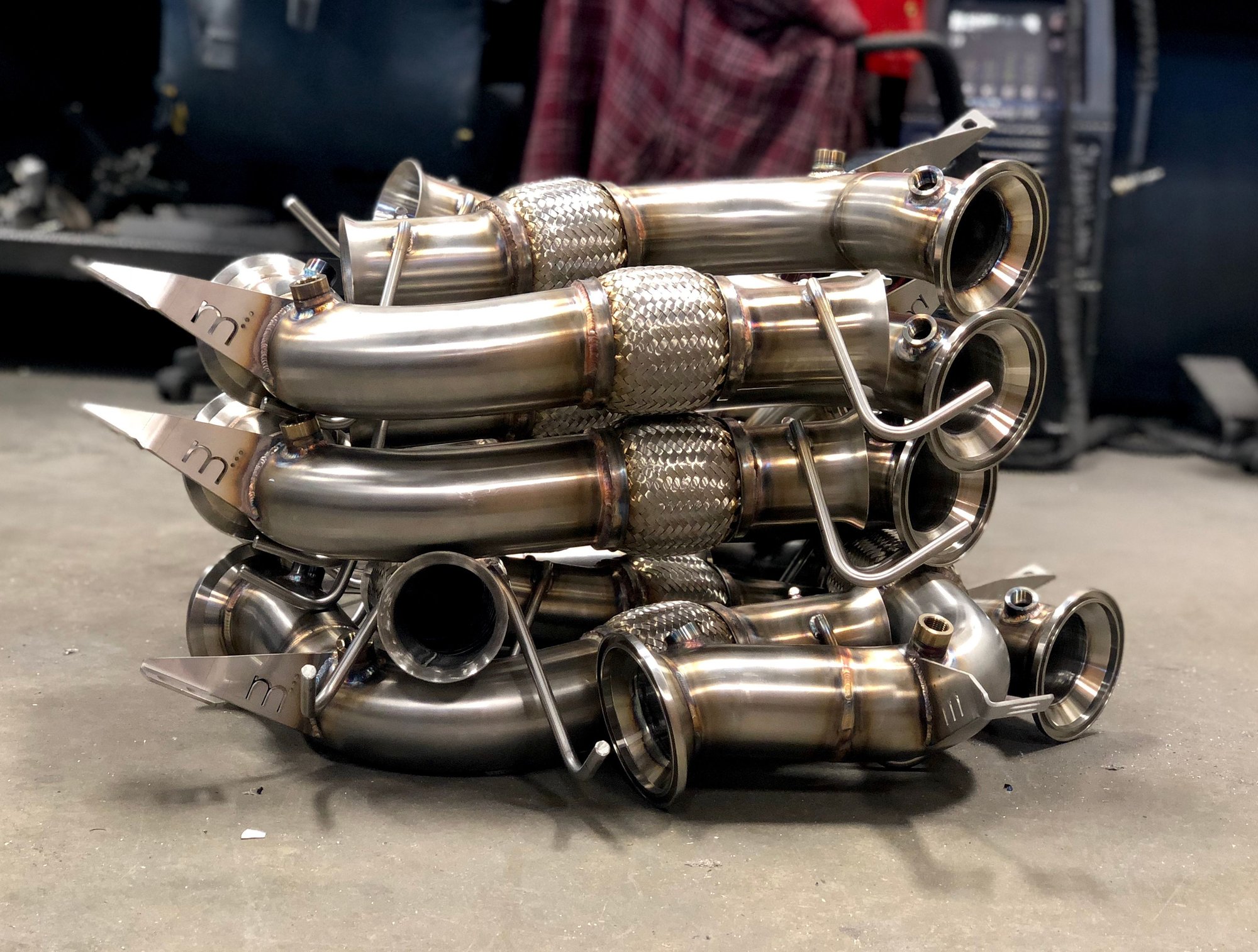

Mine don’t throw a CEL if you are interested

I have installed quite a few downpipes on gen 2 and gen 3 cars. While a tune will kill the CEL and you can pass emissions with an RPM tune. I have installed several different brands of downpipe, and several of Mariokart’s downpipe’s too. I may sound like a shill, but his downpipes won’t cause a CEL and it’s easy to see why the cost difference is there when you compare a few side by side. Mario’s stuff is top notch.
I can say that the bung extensions do not work on Mini’s. And I have heard reports that the Hi-flow catted dp’s do cause a CEL too.

I’m not sure about the specifics, but I’m pretty sure Mario uses a bit of catylist in the O2 bung or something to keep it from throwing a CEL.

I have his downpipe. It throws the code as well
