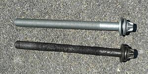

Originally Posted by Fastlane
also be sure to order a new bolt bolt for the bottom (that bolts the mount to the frame rail from underneath.
happy wrenching!
No doubt about that,
good advice.
I'm glad that I researched a little on NAM before I changed mine out and saw a warning of this, so I had a new bolt ready on hand.
I was astounded at how corroded the original was.
good advice.
When I replaced my OE mount I too was taken aback by the extend of the corrosion. Now looking at your photos it becomes obvious why. The long bolt was designed to be the sacrificial anode as the R53.2 upper mount housing is made of stainless steel. Without a corrosion mitigating device the mild steel box beam will be the one to rust. The zinc plated long bolt is there to sacrifice itself to save the Mini chassis, and is doing a hell of a job.
On the motor mount, one thing that I really regret is throwing away the expired OE mount. I tried to open it but decided that I didn't want to risk a trip to ER. A few industrious Miniacs over at MiniTorque has turned them into poor men's Vibra Technics by filling its innards with polyurethane.
GOOD STUFF!
Viewing it from the perspective that the bolt acts as a sacrificial anode is interesting,
thanks for adding that viewpoint.
