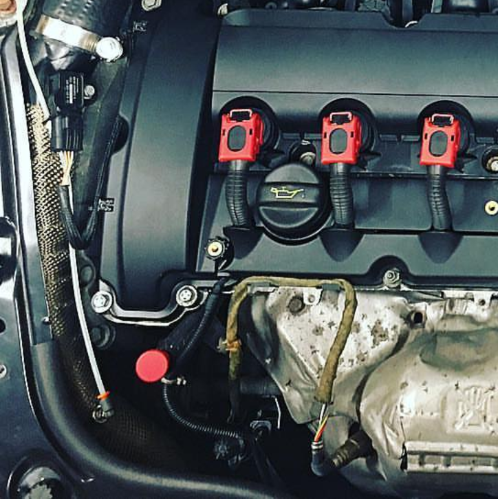

In looking at where to mount the injection nozzle, I came up with an idea - mount the nozzle into a plug that deletes the noisemaker. I think it should work out perfect - the pump and solenoid will be on the firewall just to the drivers side of my AEM intake - nice and short shot to the nozzle. Using factory washer bottle for fluid.

You need to place the meth nozzles before the map’ other wizes your ecm will not read the temp difference an not work right !
Attached Thumbnails Noismaker delete with meth injection-bf91107c-c630-49a4-bb30-46a80fefc6f5.png

On the N14 isn’t the MAP sensor in the intake manifold? Noisemaker is upstream of that so putting meth nozzle in noisemaker delete plug should work, right?
I have never ever touched my MAP sensor but thought it was in the intake itself.

They are all technically MAP sensors !
One is a manifold sensor
The other is a boost sensor
You need the nozzle before the boost sensor ‘ just like the photo I posted’ check out aquamist install kit guide ‘

The sensor on the manifold measures manifold vacuum/pressure. The sensor on the intake pipe, near the fender liner, measures both boost and temperature, that's why the WMI should be before the 1st sensor --- to sense the WMI cooling and make appropriate ECU adjustments.
