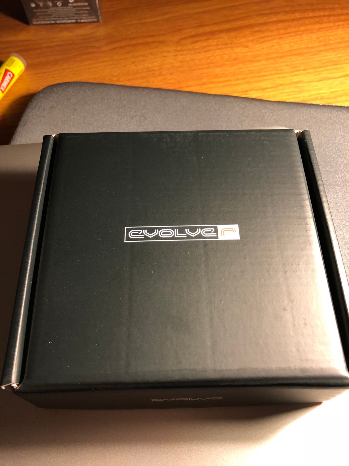

it’s here!!!

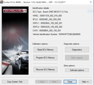

I can confirm it is working via OBD II without an ECU Patch. Now just waiting for the maps to come in via email and I can report back!
Attached Thumbnails Evolve Automotive Tuning OBD 3rd Gen MINI!-screenshot.png
