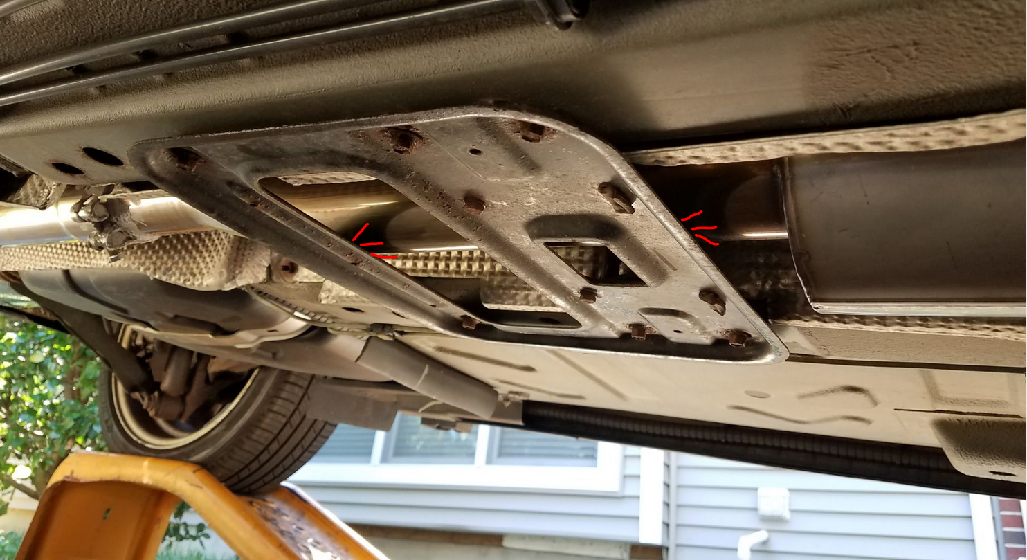

Thanks for the reply. Yes, I was definitely looking for a sportier exhaust note. If I wanted it to be as quiet as stock, I'd have replaced it with an OEM system. I wanted a deeper tone, a bit louder than stock but not obnoxious. I read a number of online posts where people complained that the Milltek was too quiet, but I figured it's better to err on the side of too quiet than too loud. So yes, I like the deeper tone; it's the buzzing and booming that's the problem.
I went ahead and put the back end up on ramps to see how the installation looks. All in all it looks pretty solid, but it does look like it may be touching the bracket/brace just aft of the resonator (photo follows). Is this the source of my problem? If so, what's the best way around the issue?

Your photo does not show well where it is touching. Exhaust touching anything is the cause of the worst kind of experience, unless you want you car to ride and sound like a race car.
I chose non-resonated as I want to avoid potential interference/touching in the tight exhaust tunnel of the Mini.
You might try to lossen some of the clamps and re-align the pieces to get the best clearance. If that fail, you can always do without the resonator. The is the risk with any aftermarket exhaust. They rarely are built to the tight tolerance of the OEM's. I have yet to receive mine.

Maybe this will help illustrate the problem. It looks like the pipe is bearing on the brace-- the little red lines show where they appear to be contacting.

behind that steel panel there are two silicone support for the muffler pipe. Check to see if they are tired or not engage the hanger bars of the Miltek properly. To do this you can unbolt the six (rusted) bolts at the parameter and lower the bracket. The two bolts closer to the center are for the two silicone rubber hangers.

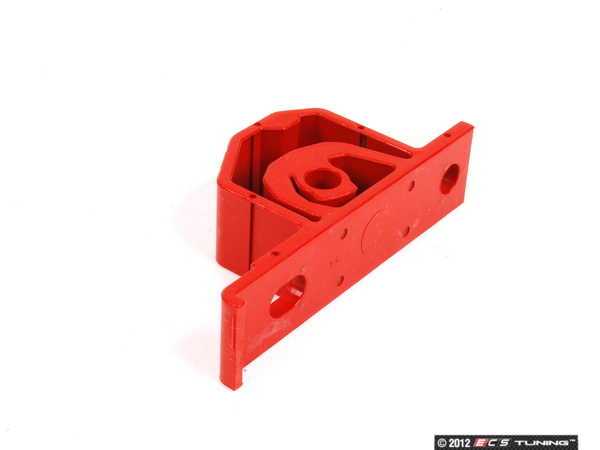

ECS sells both MINI hangers as well as the black cheaper alternative. I cannot tell from the photo is it is silicone rubber not seeing it in person and touch with my hands. May be ECS can chime in and tell us the quality.
1/3 the price of MINI
MINI

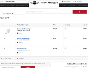

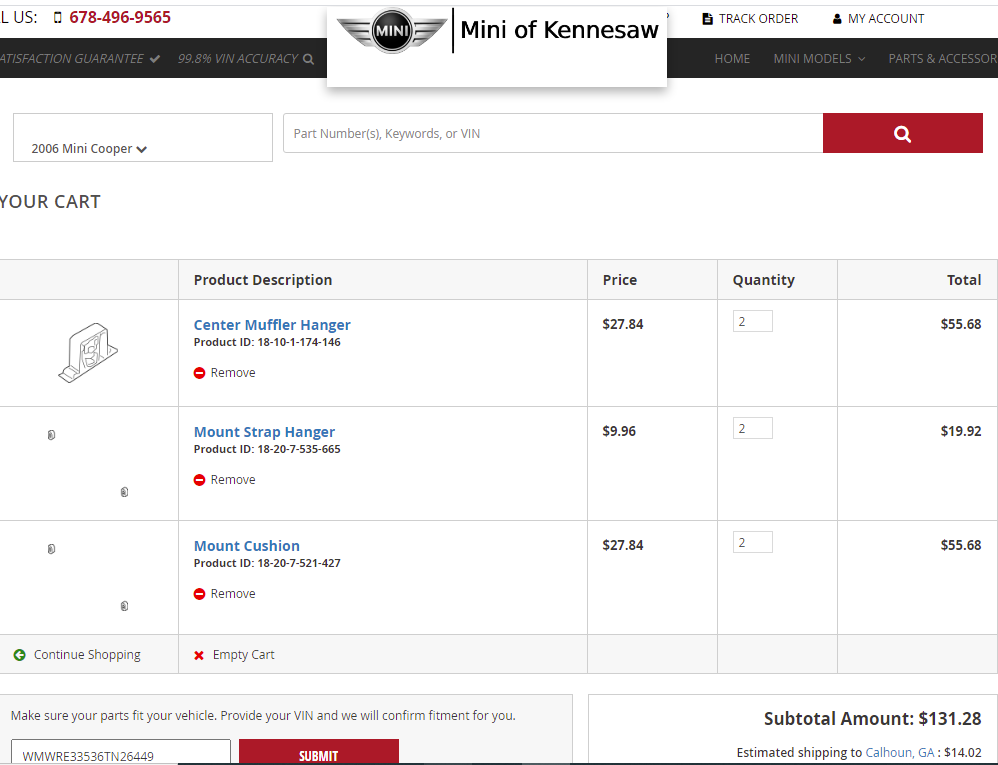

Soon to be installing a Milltek system and thought it a good idea to go ahead and get new hangers too, but JAYSUS! they gave me sticker shock when I saw the price!
The cost is rather staggering when you consider that they're just a bunch of rubber moldings.
This is one of the most irritating aspects of MINI ownership for me, that numerous small bits/pieces/trim need replacing and in doing so you get nickel & dimed to death, except that it ain't 5¢ and 10¢ but $100-$200+ a pop and it all adds up very quickly.
I like to try and support my local dealer whenever buying OE parts and they have competitive pricing too, plus it's easy for me to drop by for picking up the parts, but I'm balking on these items because it makes me feel like I'm getting seriously gouged by the BMW parts cartel.

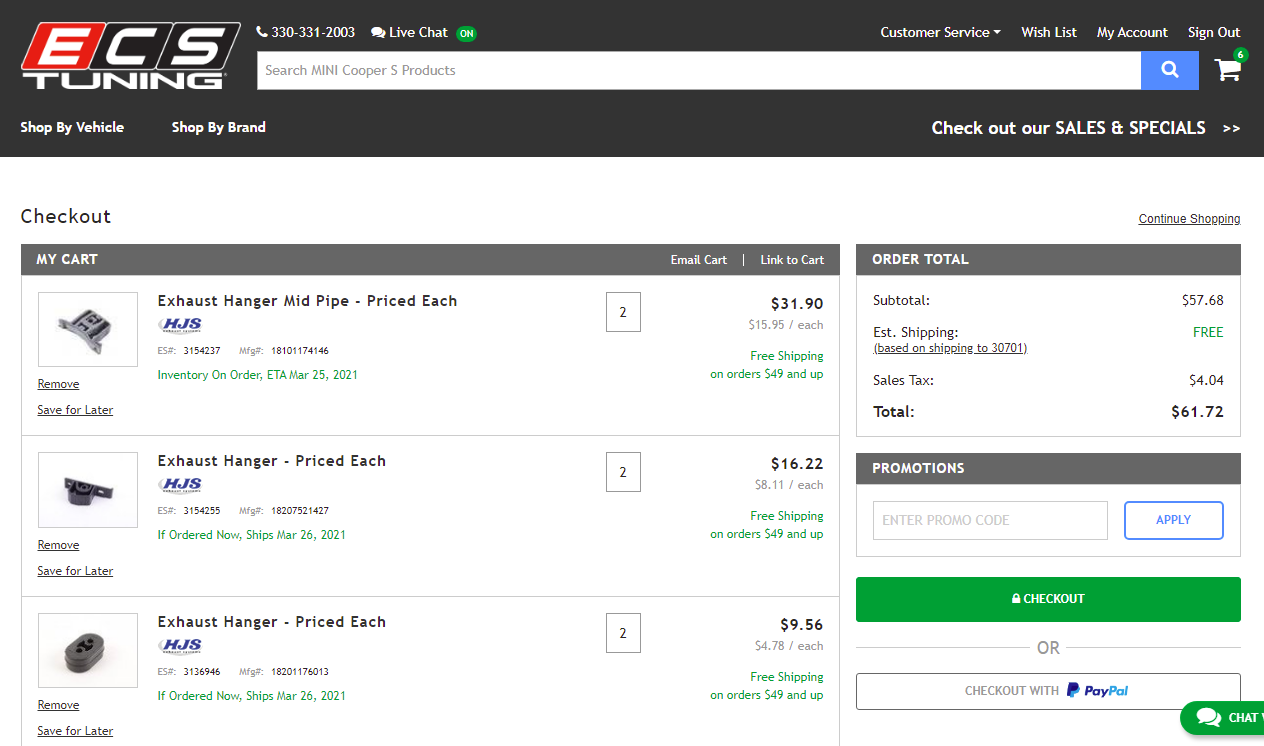

I'd love to have the red OE hangers and know that quality would be high because the originals have lasted numerous years, but I just cannot bring myself to pay the exorbitant price.
So,
I agree with pnwR53S that these things ain't rocket science and will go with the HJS pieces which slash overall cost in half, just hoping they are decently made with good material.
Anybody here happen to use the HJS hangers, and if so, could you please give your impression of quality?
Question though,
ECS has the HJS donut listed as 18201176013 which I think is for earlier cars?
I need 18207535665 -
https://www.ecstuning.com/b-genuine-...h/18207535665/
Are 18201176013 and 18207535665 the exact same thing dimensionally but just different part numbers for some reason?
