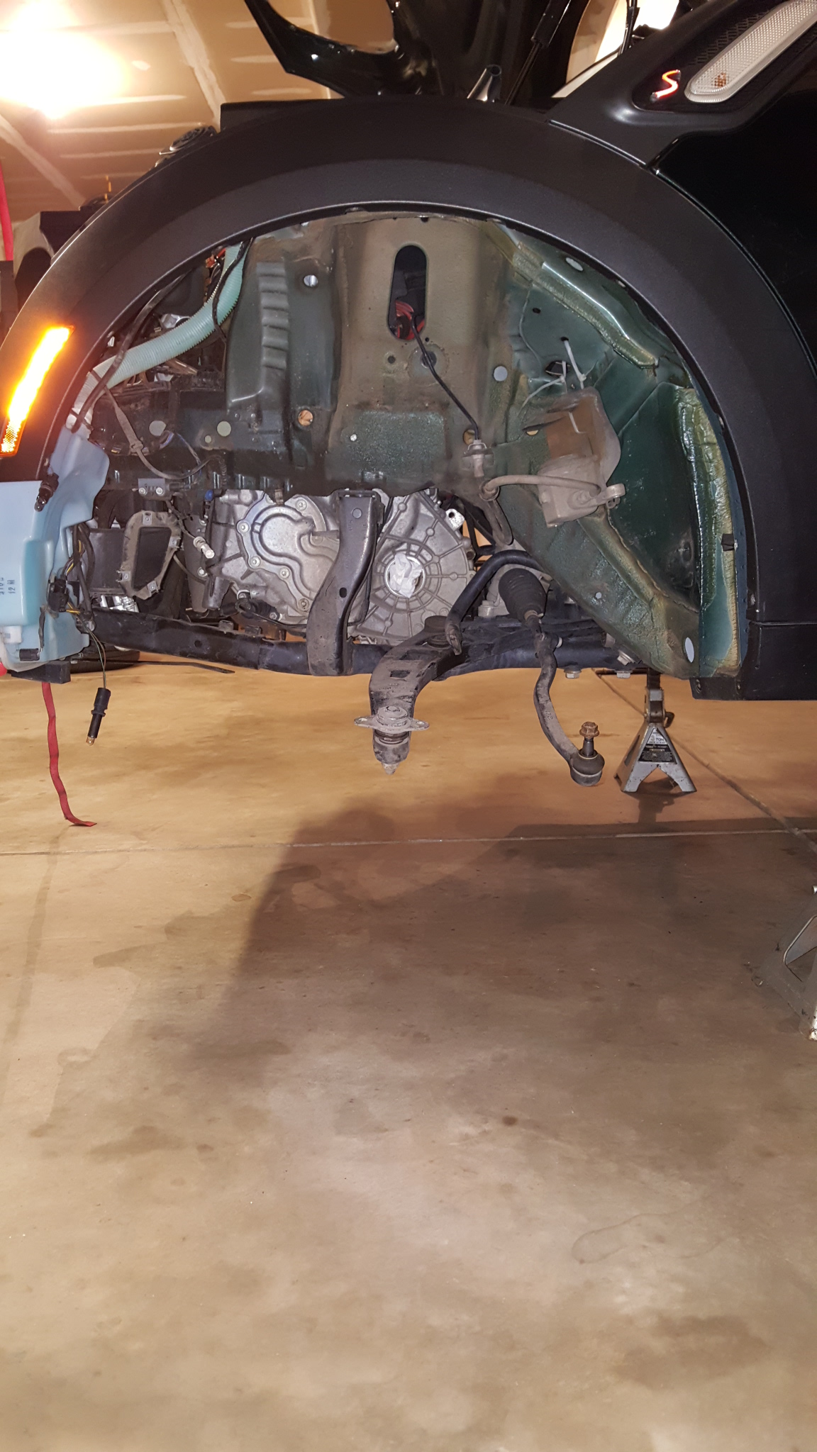

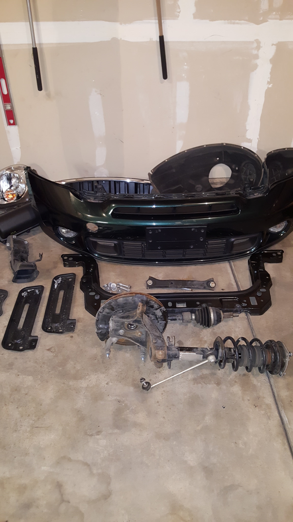

Decided to do the job myself this afternoon. I am 5 hours into it and didn't have big enough wrenches to remove the front driveshaft nut at the transfer case and no place open to buy them. Once the driveshaft is off I am probably an hour from having the transmission on the ground. Here are a few pictures showing where I am with the tear down. The red straps will hold the front end up when I drop the sub-frame.

All finished replacing the clutch. That was a big job with no reference material for the All4. The driveshaft removal was a pain in the ****. Then the transfer box has to be detached to get to a bell housing bolt, but can't be removed until the transmission is pulled away from the engine. It all went back together in about half the time it took to get apart. Surprisingly, the transmission went back on the engine first try.
