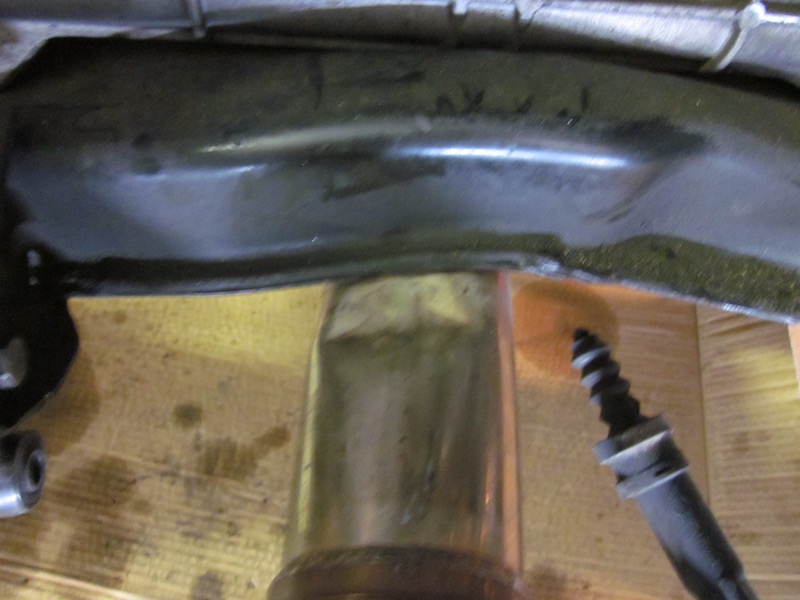

One interesting discovery —- the 3” exhaust pipe doesn’t clear the frame under hard acceleration. Notice the pipe kink where it hits the frame during “engine roll”, or torque. Gotta fix that when installing the next turbo.
https://www.northamericanmotoring.co...9&d=1471559945

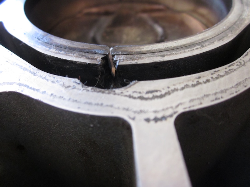

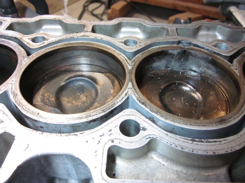

Here’s a couple pics of the damaged block at #2 piston. Another block w/crank “is in the mail”.
https://www.northamericanmotoring.co...0&d=1471559990
https://www.northamericanmotoring.co...1&d=1471560079

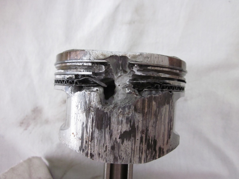

Then #2 piston. There was also aluminum “residue” on top of rod #2 —- apparently from the blown-out piston. Didn’t get a pic before I cleaned up most of it. Wrist pin and rod bushing also took a hit.
https://www.northamericanmotoring.co...2&d=1471560149

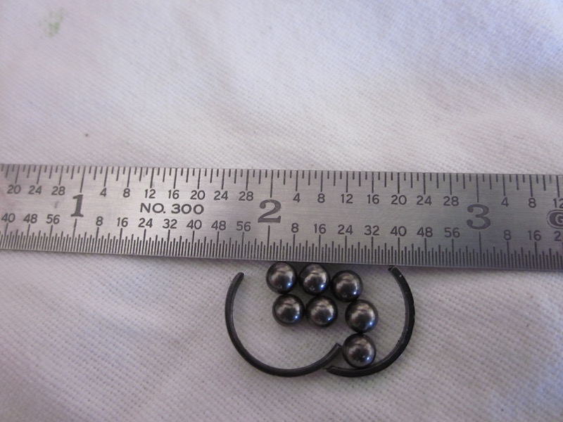

During engine teardown, I found these in the oil pan and oil pump screen. Apparently from the Garrett turbo.
https://www.northamericanmotoring.co...3&d=1471560197

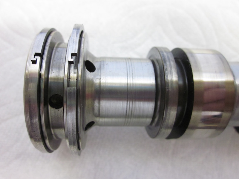

Pic doesn’t show it clearly, but all 5 of the intake cam journals, cam, and caps are scored. Plus the cam has one of the two interlocking rings broken —- the rings that fit inside the vanos unit. The ring might be replaceable but the journals need to be machined. If machined, they wouldn’t fit the head without building up the 5 journals, then line-boring it to accept the machined cam. Not practical! No damage to the exhaust cam or its journals.
https://www.northamericanmotoring.co...4&d=1471560235
Did a partial tear-down on the Garrett and convinced myself that the bearings found in the oil pan came from the turbo. Turbo also has a slight amount of end-to-end shaft play, so it’s on the “replace” list, not repair. Have no clue how / why the bearing failed. It was performing nice up until the engine blew.
