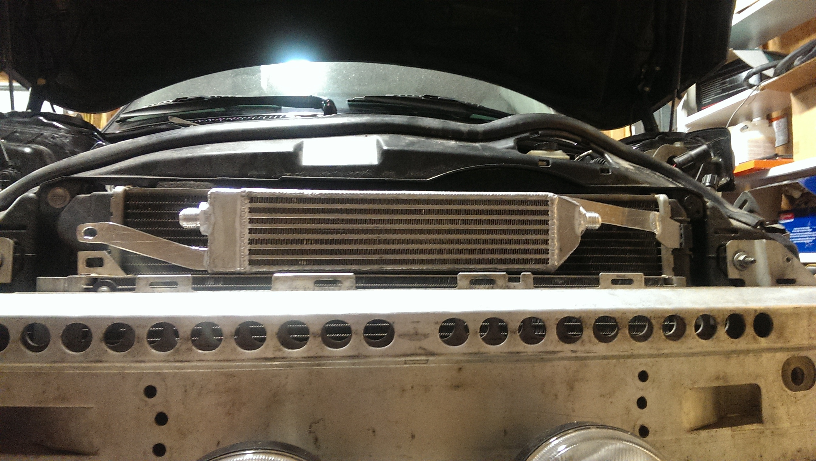

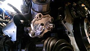

I know i open very old thread.. but i have some questions about oil cooling.. maybe someone here will have answer.
After full rebuild of the engine (was rebuilded because of possible failure after to much temperature on the track) we added oil cooler kit with mishimoto thermostat.
The cooler may seem to big but this is a topic for another day.. because we cannot achieve temperature to even open thermostat (88C).. max was 76C.
I don't know, we put hoses in the filter housing wrong way? Or simply size of the hoses to thermostat makes them cool oil not only flow..
Some photos of install
That almost looks like too big of an oil cooler for it fo reach temp for the thermostat to even open so it can flow. I know mine (although not installed is probably half that size for the core. Really depends on where you live as you may not even need the cooler. Also it looks like your kit you opted for the external thermostat so not sure if there's any extra hoops when fitting that not just the lines and couplers and plate. But I'd do the obvious and make sure the hoses aren't switched around and let the car run for a few to see if the thermostat opens. If it never reaches the set number you might want to go to smaller core cooler so you can bring up the temp a few degrees. There's a reason why these generally aren't very big for our cars.
