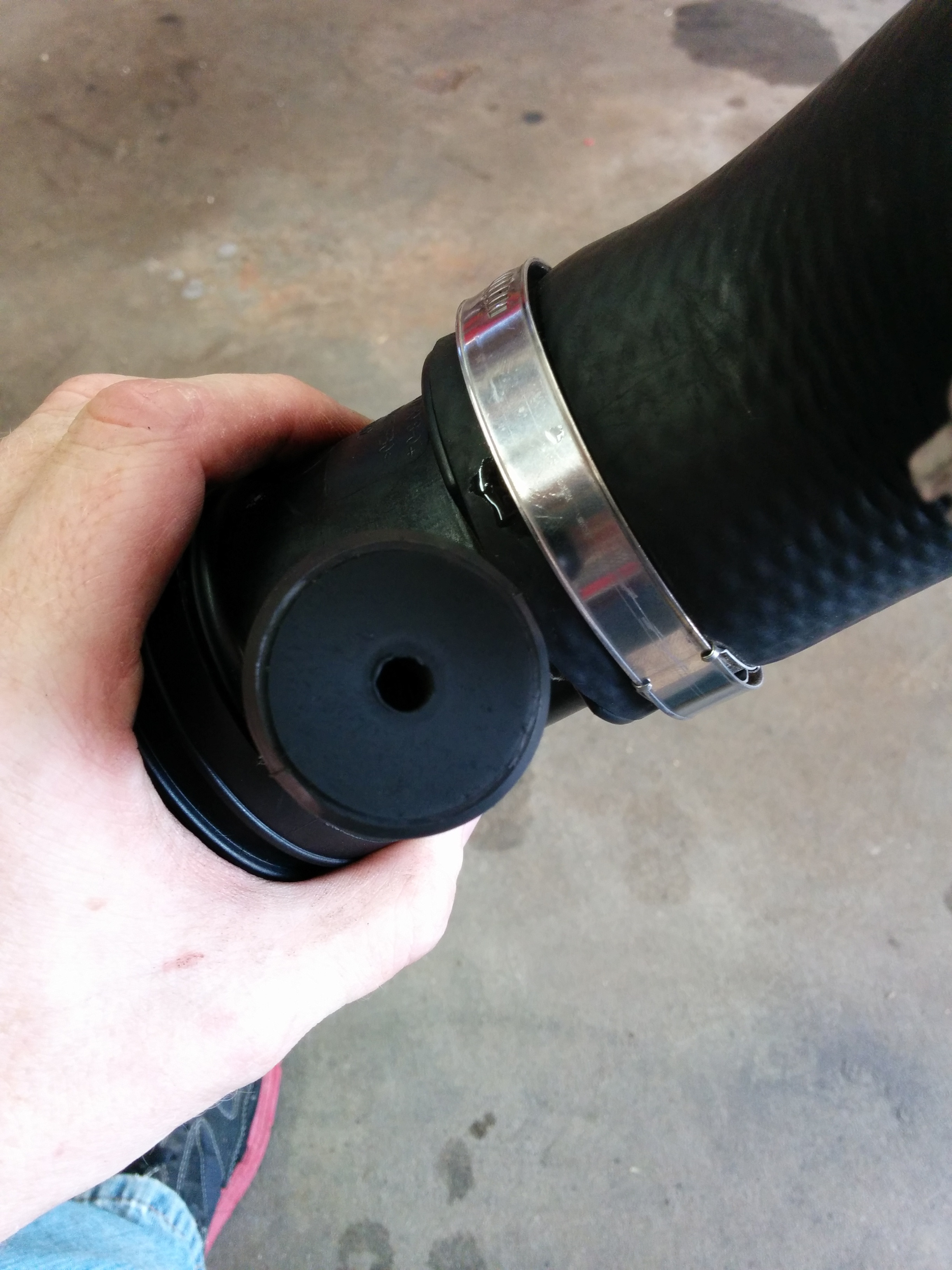

While I was was pulling apart the intake tubing I figured it would be a perfect time to remove the noisemaker and install my AEM intake that I picked up recently, so I bought a rubber expansion plug to do the noisemaker delete.
I removed the stock airbox and charge pipes just before the throttle body and started the noisemaker removal first. The expansion plug was too large so I chucked it up in my drill press and used some 120 grit paper to reduce the plug to a size that would fit into the charge pipe with a little bit of lubricant (glass cleaner) and force.
