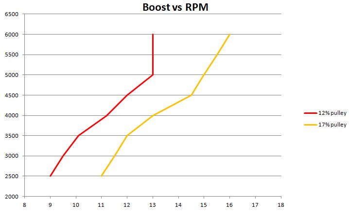

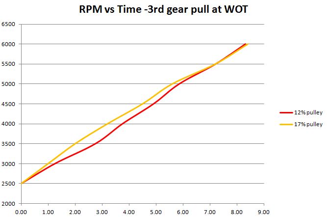

Here are a few graphs a made after doing some data logging. As you can see, I'm definitely getting more boost at all rpms. What I found interesting though is that you can see the motor pulls harder in the mid range, but after a WOT run in 3rd gear....both the jcw pulley and 17% pulley ending up getting to 6000rms in the same amount of time. In other words.....0-60 times for example, would be the same.....but you are going to see more midrange pull from the 17% pulley, then it ends up pulling less that the JCW pulley at the higher rpms.
I guess that's when the hotter IAT's start overcoming the additional boost and start taking power away. You can definitely tell it's got more midrange pull....which for a daily driver car, it what I was wanting.

Did you change to a smaller belt? Perhaps there's belt slippage with the smaller pulley. A 3psi increase is something that should be felt; it's not drastic, but is significant.
iats def play a big role. i would also check your tensioner assembly.
when i went for my tune, the car was putting out strangely low numbers for the parts that are in it.
we found the belt was slipping (it was brand new) at high rpms, due to the shock style tensioner being worn.
we installed an entire new tensior assembly and then put down an additional 18hp.
if you have the resources to test, make sure that belt isnt slipping. itl rob you blind at top rpm.

Yes, I'm running a new 532 belt.
