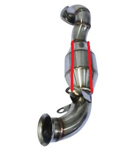

I agree catless.... but it looks like its the same DP for cat or catless...
if i go catless i wouldn't want the pipe to swell out and then back down.... same diameter pipe all the way down ...
I'm new here and not sure how to post pic... let me see if i can figure it out
Old Jan 31, 2014 | 07:14 PM
ridinDirty's Avatar
ridinDirty
Joined: Dec 2013
Posts: 507
From: Vegas
well i wanted it to be bigger...lol will work on that...
but you can see the redlines , seams like if you don't have cat inside you don't need to swell out to a larger surface area to keep the flow up due to the resistance of the cat inside....
just keep it same size.... by swelling out you are creating a stall in the flow for that pressure to build in the bigger area before it starts to flow out the rest of the exhaust.....

maybe i found the reason...... resonated ?? so its like a muffler inside the swelled part ?
so is there 3 types ??
cat
catless
resonated

Pretty sure the catless downpipes Way sells are just a single diameter pipe. which one are you looking at that has a lump but no cat?

WMW Catless Downpipe
As you can see the pipe is just straight. If you had a change in size it would cause turbulence in the exhaust flow.

Thanks WAY, this is more like it in my eyes...
that pic is from CNT website, listed as catless. maybe they just use a generic picture, but a few other website look like they do the same
Thanks again for clearing this up WAY....
what size do you offer ?
John , does your iPE look like the above pic for your catless ???????

John , looks like your catless does swell out. Did you by chance look inside the pipe to see if it had a resonator in that part ?

The downpipe iPE is a 200 cell high flow cat. It is NOT catless.

I have the CNT catless downpipe. It is resonated.
