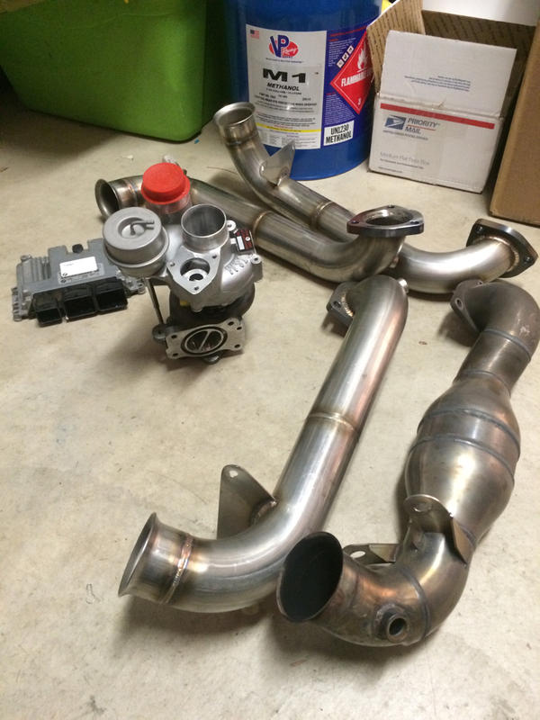

Originally Posted by wzabrouski
Wana sell me your stock turbo?
Wish I could, but I sold it already. I do have more 47's forsale, I a dealer now mQubed Motorsport, Manic Tuning Dealer

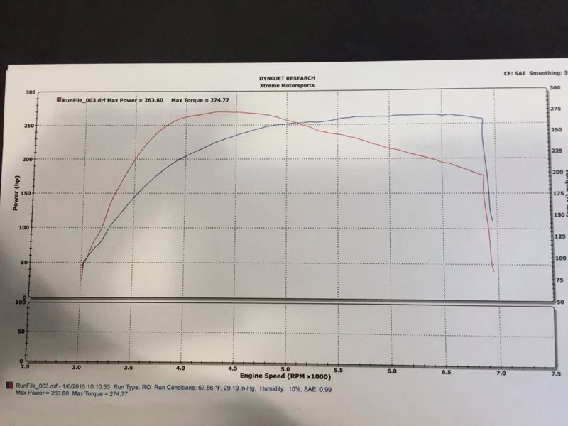

Manic Motorsport brings us N18 owners OBD II Tuning! Solution is finally here!-image-2989640660.jpg
From the Eurotechs FB page. Not too shabby at all!
That's a nice graph, what Mini and mods?
I'm getting excited about my 47mm Turbo going on tomorrow. I will keep the boost at 22psi and then load files and talk with UKManic to get it where I want. I'm feeling better because last week I put a scope to check the piston surface and material, it looks to be forged. The GP piston have a much more aggressive dome (even though they are the same CR) and the material doesn't look like the typical cast material in an N18 S. I do plan on taking the motor a part and flowing the head in May this year.
Attachment 104558
The Dyno sheet is from a Stage 3 2013 JCW hardtop
Owens turbo set to 1.6 bar
100 octane fuel with a splash of meth.
That is the low boost tune , shows how much more the Owens turbo makes compared to the JCW turbo at the same boost level.
Here it is on same sheet to show the difference in the turbos side by side. Same boost levels same 100 octane fuel. This is the same boost level most stage 2+ cars are running.
