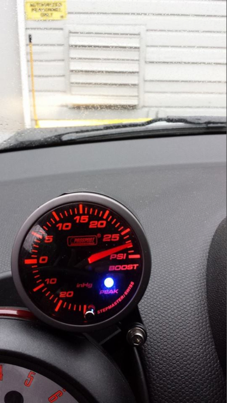

This is from a countryman page on FB. This guys is supposedly running a Manic tune with aftermarket turbo. Playing with fire in my opinion. Only a matter of time before boom, pop.
Manic Motorsport brings us N18 owners OBD II Tuning! Solution is finally here!-image-527946410.jpg
Attachment 99252
It also looks as though he's running headlong into a wall at that boost. Yes, I kid. But boost this high on pump gas is certainly going to cause knock and detonation. And even if running very high octane, I'd suspect this is too much airflow for the stock connecting rods to bear.

I would hope he is running meth or race gas on map C.

He is running meth but still...

Those damn weak rods. I know it's a reality, but like most of us, we just hope it won't happen to us. I did blow my modded R53 twice, so its always at the back of my mind

I would be more likely to believe that boost number if it was not a prosport gauge. They are known to read wrong on the high side by a lot.
I know the target boost pressures of the Manic tunes up to stage 3 cars and none of them are that high or anywhere near that yet.
