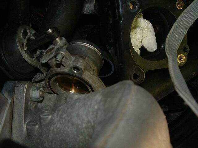

Is it possible for the bypass valve to be misadjusted and go "over center" so that in the zipped position, its really partialy open? I noticed that on all the other runs there is a slight change in the slope just before reaching max pressure, but not on the zipped runs. In my theory the valve goes past full shut and starts to reopen slightly as the mechanism hits the stop when you zip tie tie it, but under normal operation the mechanism goes to the fully closed position but no farther because there is nothing to drive it past the fully closed position, ie the spring is fully extended.

The bypass is closed against the stop when the engine is off. When the engine at idle, the bypass is visibly open (90 degrees from the stop). I'm not sure what position it has during operation (tough to see that while driving). :smile:
It definitely could be possible that the butterfly is overshooting its stop ... that should be adjustable using the stop screw.
The same thought had occured to me Andy, but if the butterfly were over-rotating past closed when zip-tied, the same should be expected under WOT no zip tie, right? Unless something holds up the butterfly at closed when it's vacuum driven and you're able to force it past that something with the zip tie (lot's of speculation here).
It's certainly worth a look down the barrel of that bypass valve. You never know, you might have some free boost there, waiting to be recovered! I haven't tried yet; how hard is it to get a look INTO the valve? The HAI should give you a little head start at getting to it. :smile:

No overshoot:

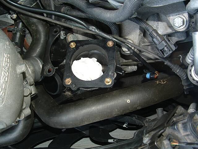

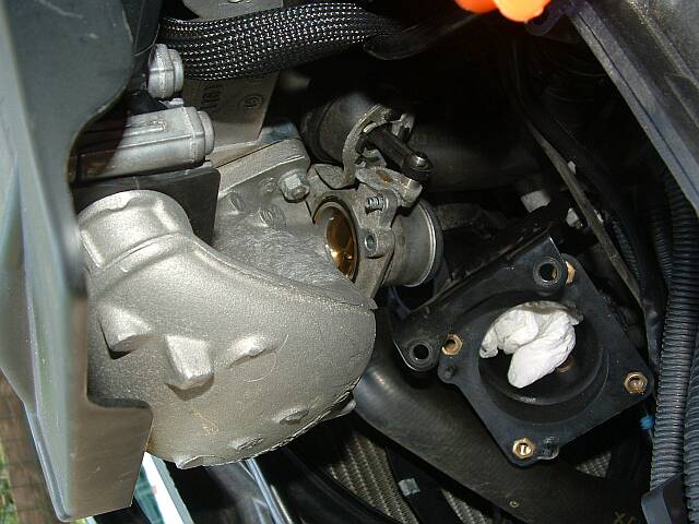

Here are more pics of ye ol' bypass valve:
