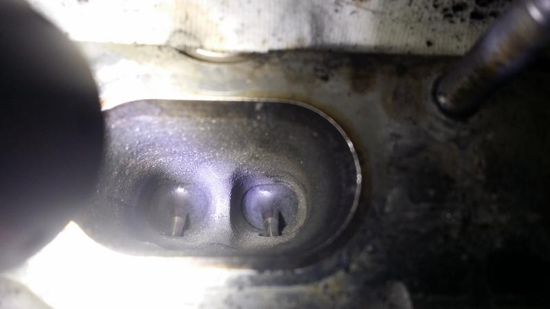

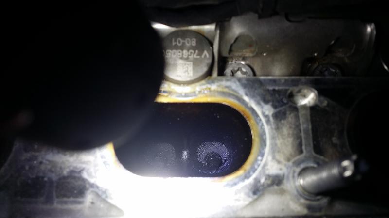

Good morning,
I spent the better part of last Saturday (11am to 6pm) removing carbon from my intake valves. This was actually a very easy procedure, just very time consuming, very. I did this by myself so in order to get the valves to close I put the car up on a jack, removed the passenger side wheel and removed two of the front inner-fender fasteners and turned the crank (clockwise) with a socket/ratchet until I felt the compression stroke (most resistance during the turning process) and this was how I knew the valves were closed. I also sprayed a little of the carb/choke/throttle body cleaner in the ports to determine which valves were closed. While I worked on one port (outer cylinders are synced as are the inner cylinders) I sprayed the cleaner into the other port to allow time to soak.
This was a very nasty set of valves (see pics). Carbon was caked on the valve stem and the top of the valve. I am not sure how the hell this thing ran before. I had to clean them 5+ times each port. I invested in a long pick set (6 pieces) to which I used very one (very helpful). I also used a dogs tooth brush (from Petsmart). They are long and they have a small head with stiff bristles on them to get between the valve stem and the outermost part of the port. Worked like a charm. I also had an array of metal and nylon brushes to clean ports.
Interestingly enough my throttle body and runners once removed from the car were not even close to oily or coated too badly in carbon/oil. Not sure how the intake ports could be so bad(?). Nonetheless I sprayed them clean with the B-12 Chemtool (Carb choke throttle body cleaner) .
I found some instructions here on NAM that were very helpful. The one thing the instructions did not tell me/you is that there is a bolt on the lowest part of the intake manifold/plenum that supports the bottom of the manifold/plenum. This bolt was only accessible from the top (my hands were too large to attack it from the bottom). This was my only ‘hold up’ as I tried to figure out how the hell it was still being held onto the motor. Another thing that would have saved my some time was remove the manifold/plenum with the intake tube (the 90 degree elbow that connects the intercooler plumbing to the throttle body) by disconnecting the ‘quick disconnect’ to the left of the motor just before the piping turns down towards the sound generator.
Other than that the job was a snap. My other problem is that this did not fix my hiccup that the car has while lugging the motor from say 2-3k rpms. I believe this is a fuel pump issue.
I received a letter in the mail about my timing chain so I’ll have the techs check it out then.
If you have any questions for me let me know. I have replaced my water pump, thermostat housing, turbo oil supply lines, lowering springs and have now cleaned my intake valves. While the lowering springs are the easiest thing I've done the intake valves are pretty easy too. Knock on wood….
