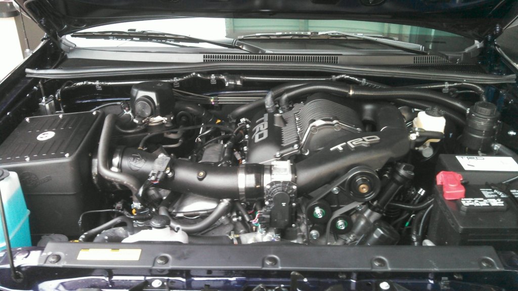

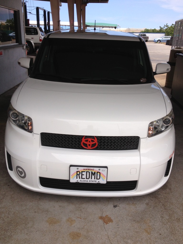

Coming over to MINI from the Toyota world I loved that my xB intake was designed to pull air from a frill insert left front bumper...its tight under this hood...temps are high...I pulled out my insert in attempt to cool it down...
Old Nov 16, 2013 | 06:58 PM
Melangell's Avatar
Melangell
Joined: Nov 2010
Posts: 2,466
From: Savannah Georgia
Originally Posted by carhopper
This forum is designed to provide help, ideas, creative thought. Please refrain from using insults as it stifles all three.
Ouch.... a forum I've been a part of for longer than you. Cold air is cold air. Care to question it?
Old Nov 16, 2013 | 07:07 PM
elsenordave's Avatar
elsenordave
Joined: Nov 2013
Posts: 367
left front grille was open to allow air to the downpipe of the intake...True CAI
Even in my Tacoma the air comes from outside the engine compartment

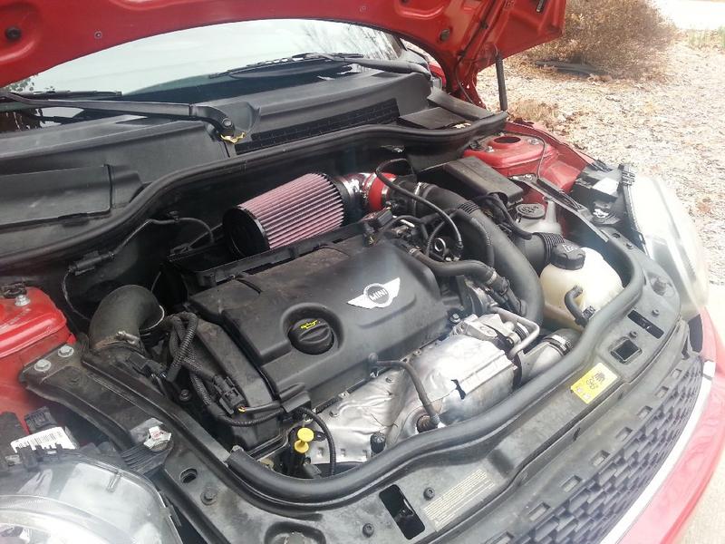

Sorry it took so long to report back but the reducer came in 2 days ago and I was out of town this week. I got it installed and for all intents and purposes it looks OK. I knew it wouldn't be as pretty as the K&N with the custom bracket, but has the exact same effect. Although in my install the MAF didn't have to move. I'm also going to put a tie down strap of some kind so it doesn't bounce around.
I took it out for a run a little while ago and I absolutely love the turbo sound and the bypass valve. You can really hear the pressure build and the loud whiiiiish sound when you let off of the throttle. I did a couple of hard pulls and no CEL yet. I'm going to be monitoring the AFR in the weeks to come, but unfortunately I don't have a long trip planned until December now. As for extra power, who knows. It feels faster but the sound makes power gains/losses deceptive. I just know that the sound of the turbo makes me want to drive it like I stole it all the time now.
Old Nov 23, 2013 | 12:53 PM
Mcameron's Avatar
Mcameron
Posts: 329
From: Massachusetts
looks good!....
my only comments would be that you should try to make a bracket to support the filter so it isnt bouncing around putting stress on the intake tube.

I already put a large zip tie for now. I used one of the 3 front screws with a loop hole from Advance Auto. As for the parts, they are below. I would get a better 3" to 2.75" coupler. This one was cheap, but a little tight. I had to heat it with a hair dryer to get it on, but maybe that's good. It will never come off.
K&N RE-0910 High Performance Universal Air Filter
Sold by Amazon.com LLC
$39.24
Spectre Performance 8698 Chrome 3" 90° Elbow Air Intake Tube
$11.56
3"-2.75" Intercooler Hose Reducer Coupler Intake Turbo Red (#Rd-3-275r)
Sold by High Performance Parts
$4.99
