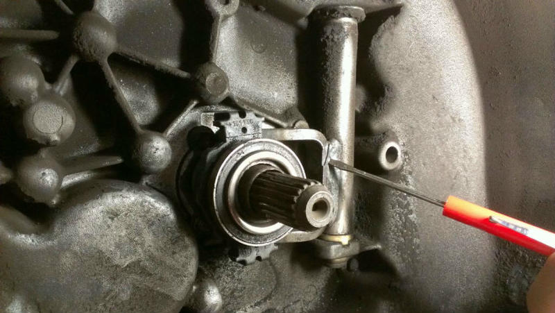

2004 Mini Base, 107K miles, clutch had been replaced at 86K. Difficult to shift into 1st and 2nd, some grinding into reverse. Replaced the Clutch Slave Cyliner, and now could not shift into any gear; clutch was not disengaging. Dropped the transmision and found the Throw-Out Fork was cracked (see photo). With the extra travel provided by the new slave (and bleeding), the Throw-Out Bearing was side loaded when trying to slide and would bind, so the clutch was not disengaging.
