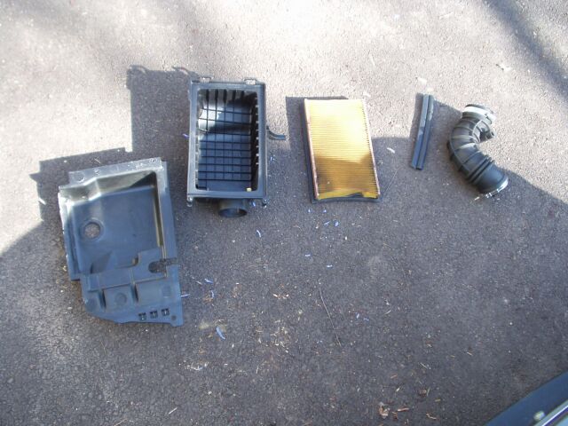

I have tested a total of two intakes (stock and Alta) and found that the Alta showed significantly less restriction than the stock one:
That's the pressure as measured between the throttle body and supercharger. The ~0.5 psi gain showed up as about the same gain in boost in the manifold. Other intakes may perform better or worse than the Alta, but I haven't seen any such data on them.

Nope, the stock paper filter had maybe 10,000 miles on it, but was in pretty good shape:
I had measured the pressure drop between the dirty and clean sides of the stock airbox at WOT, redline, 2nd gear as ~ 0.14 psi:
https://www.northamericanmotoring.co...amp;topic=8631
I never tried to make my testing past the rigors of the scientific method, just give me a good rough guesstimate of the types of pressures involved.
