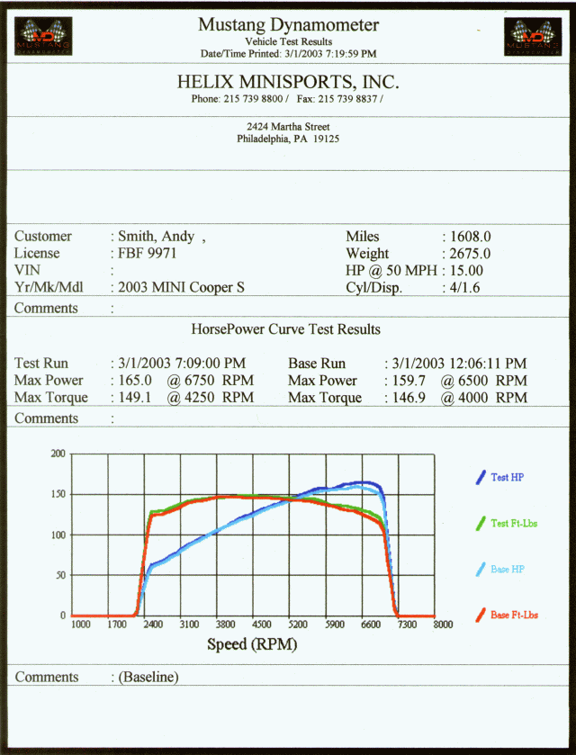

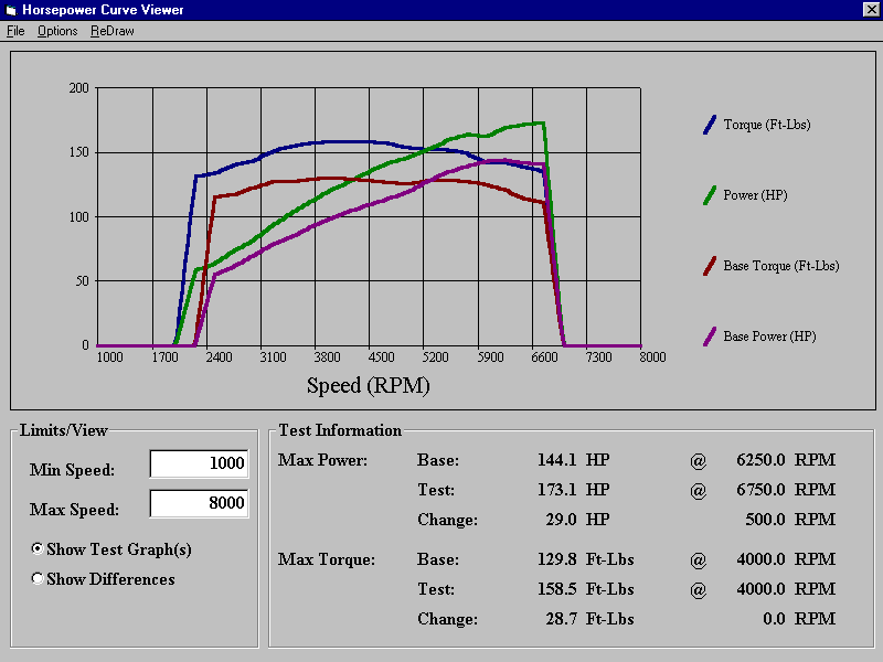

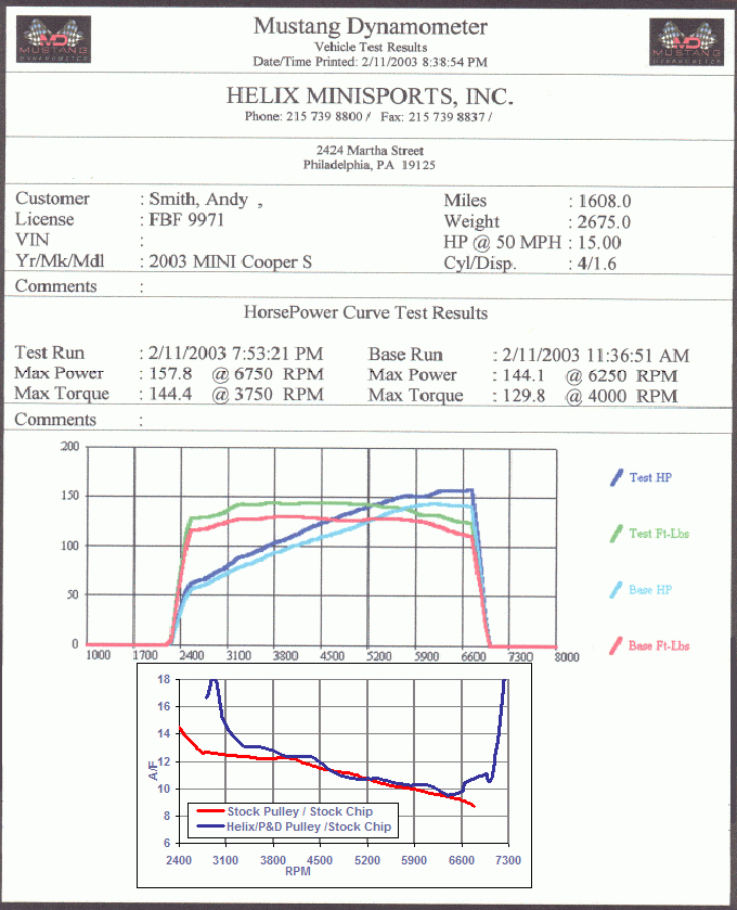

prolap wrote:
Good! Be skeptical about performance claims, especially when they come from someone selling the parts.
Roughly speaking, I went from:
144 whp / 130 lb-ft stock
http://www.ross-tech.net/andy/mini/h...stockstock.gif
158 whp / 144 lb-ft stock+pulley
165 whp / 149 lb-ft stock+pulley+exhaust
http://www.ross-tech.net/andy/mini/m...navspulley.gif
173 whp / 159 lb-ft stock+pulley+exhaust+intake
http://www.ross-tech.net/andy/mini/173vs144.png
The last link shows the overall effect of those 3 mods, +29 whp, + 29 lb-ft.
Those runs were on different days, temps, etc. so take them with a grain of salt.
