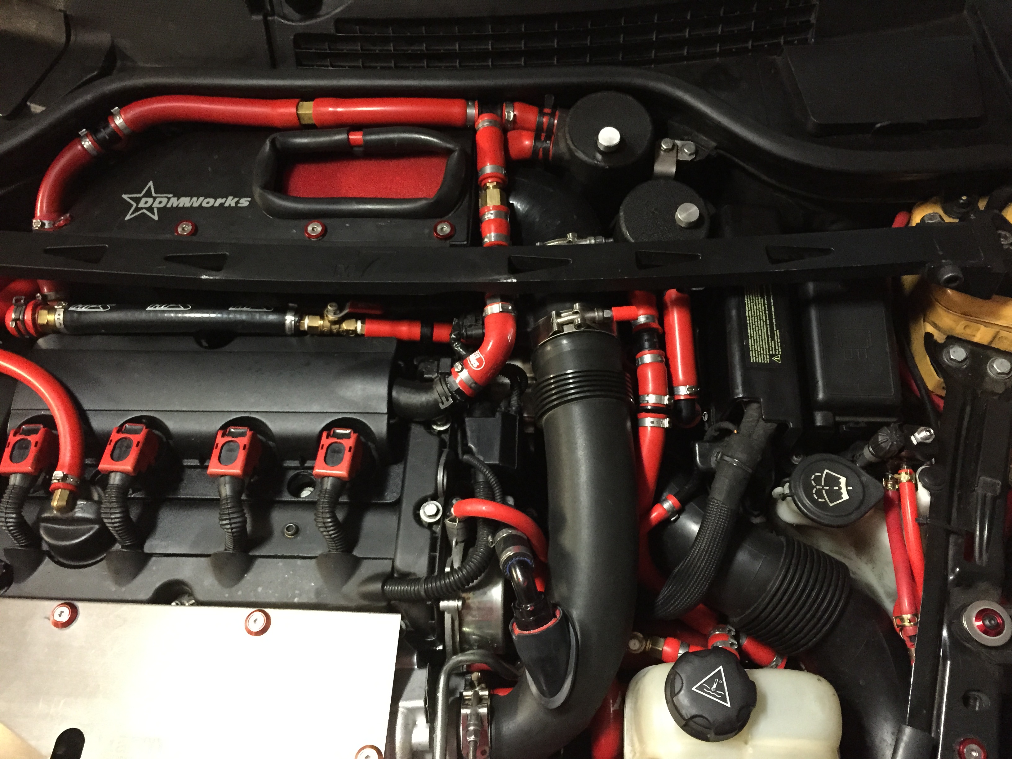

They are all dirty sided; pass and drivers. Only a smidge of draw from drivers side when at idle and just off idle; and in a useless area at that.
Other than long decels/throttle closed, the CC is a pressure chamber looking to vent anywhere; usually down the path of least resistance.
Plumb both dirty sides together and into the OCC. Then do what you want with those fumes.

Vacuum on pass side only when engine at idle and decel only.
Its at this point the drivers side will allow air into the valve cover(where its useless really as it only dilutes the CC vapors
Vacuum/pressure is limited on both sides of VC under varying conditions
The VC has a quasi PCV valve/oil separator and 1 way valve built in
Vacuum from intake manifold turns to pressure on drivers side. Under boost it then gets shuts down by VC 1 way valve.
Its at this point the drivers side will only VENT into the turbo inlet side (very bad)
At this point there is NO "fresh" air going into CC, only pressure in the CC.
The much valued oil can is doing nothing when one needs it most.
BTW here's pics for nay sayers.....

Which is addressed with the dual checkvalves and utilizing the turbo inlet suction when at boost. The point I have been trying to make all along.
This always retains clean in, dirty out and never allowing pressure to ever be present in the crankcase. 16-22" at idle and deceleration, and 4-6" during boost. If more vacuum is desired during boost, then add the venturi valve system and get 12-16" at full boost.
So, the PCV system never "flows backwards and quits evacuating" like leaving it stock does. Flow remains in the same correct direction at all times and only clean in, dirty out period.

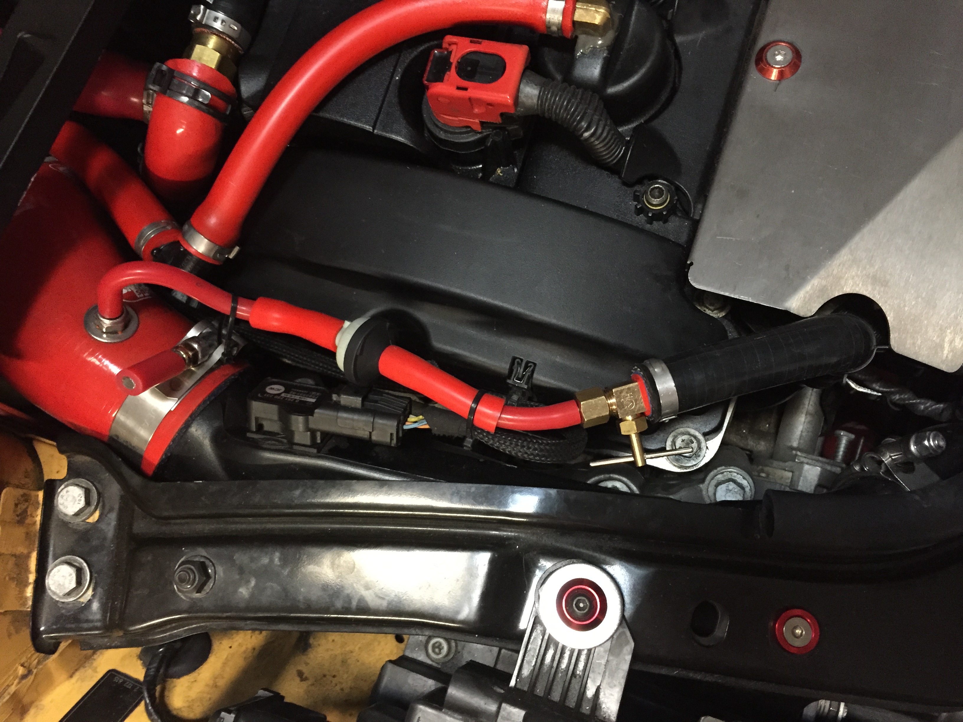

There is none as I have always said. Nor does there really need to be one.
I ran air into the oil dipstick tube for kicks
Technically there is a restricted amount of air allowed in at idle and just off idle. After that there's nothing but pressure in the CC

Final Analysis?
Originally Posted by WrenchMonkey
I have the routing set up relatively identical to how you have it set up in the youtube video you did on an N14 engine. Unfortunately my engine bay isn't as clean as in that video from the carburetor cleaner spray I was using to try to find vacuum leak... damn nozzle broke and leaked everywhere. I used propane too and couldn't find vacuum leak anywhere. The valve cover is brand new, doesn't even have a thousand miles on it, the drain valve was closed, all the hoses well connected and tight, I had to tow it in to the dealer today so we will see what they come up with. I exhausted myself tirelessly troubleshooting every little detail that I possibly could and though I replaced some of the vacuum lines, double, triple and quadruple checked all my work, verified cylinder compression, tried reverting everything back to "factory" condition (which failed but then made me not angry at the OCC as much which is kind of a win..). In the end this is my conclusion: During the initial process of removing the intake and dicking around with the two vacuum related devices that attach to the underside of the intake I must have damaged or rendered one inoperable OR due to some kind of technowizardry involving the 1's and 0's of the electronics chose to put the car in limp mode while I was disassembling things and testing the fit of various electronic connectors before reassembly and despite everything being reconnected properly refuses to come out of "limp" mode. But frankly I don't know, or my car wouldn't be broke and at the dealership. The dealership has generally always done right by me but I'll be damned if I go as anything but a last resort. Just getting the car there has already got me out of over 100 bucks... there's no telling how much they'll rack up before things are fine again... and that doesn't even touch on the exhaust leak issue I just discovered (although it does give me a particularly good excuse to pull the trigger on a new downpipe... double edged sword I guess).
I'm curious what the dealership will say about the OCC though.. lol. I did try to give them as much of a pass down as I could, they certainly didn't seem surprised when I mentioned it
WrenchMonkey-
How did your trip to the dealership turn out? I'm struggling with the same issue - a vacuum leak that I can't find. My set up is very similar to yours - I have the K&N Typhoon CAI as well....although I don't that is the source of my problem. Only one of the connectors from RxSpeed fit my car, so I've had to improvise.
Update 2/26/17: I never received connectors that fit my car from the vendor. I tried several cobbled together things, but they always ended up with vac leaks. I spoke with the vendor, exchanged pictures and emails....finally, the vendor took the connectors back, but not the catch can and other parts. They're in my basement. Big waste of money and lots of time for me.
