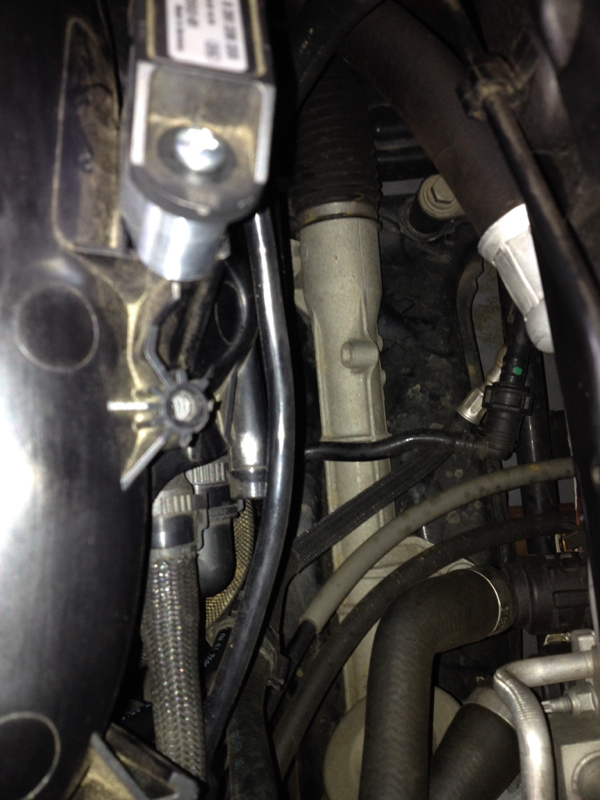

Old Apr 13, 2014 | 09:10 AM
nap220's Avatar
nap220
Posts: 12
Is the diverter valve different from the bypass valve/BOV?
Installed a Forge BOV yesterday hoping that might solve the issue...still having the same problem.
I did notice on the back of the intake manifold what appears to be a hose connection with nothing connected. Can't find any hose anywhere that is loose. Is something supposed to be connected here (see picture)?
