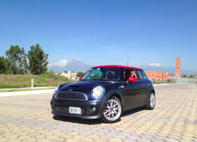

Im running the BBS R90 two pieces wheels, so I will need spacers at least 15mm I guess.

This is my car:
