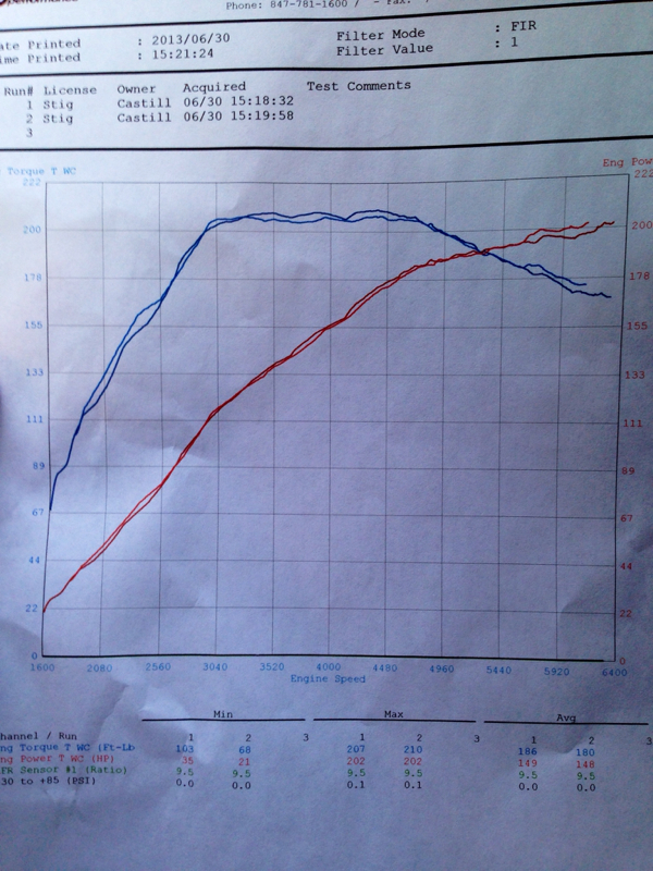

FINALLY!
Made it out to make a dyno run yesterday.
Unfortunately, the mustang dyno software they had did not have calibrations profiles for any year of Mini. So we had to guess. Not thrilled.
Also, it's been brought to my attention that mustang dynos have a tendency to read lower than dyno jets, especially when improperly calibrated.
That being said, 210tq/202hp. Not far off from what I expected, especially since my exhaust still has the factory neck-down choke points.
Attached Thumbnails Opinions and Question About Mods (N18)-image-2283226325.jpg   Opinions and Question About Mods (N18)-image-2761704777.jpg

Cool, thanks for posting this Tony! I was just wondering if these numbers include the overboost function into account.

Cool, thanks for posting this Tony! I was just wondering if these numbers include the overboost function into account. Sent from my iPhone using NAMotoring
I don't know for certain. I can't imagine why they wouldn't, but then again I'm not exactly sure what the conditions are that trigger overboost to come on.

It's supposed to be Stage 2. I'm assuming in putting down stage 1 numbers because I'm essentially still running a stock downpipe-back exhaust system. Although I cut the 2nd cat and resonator out, I still have the factory piping in place back there with all it's choke-down points. I could really stand to see an improvement with a real catback of larger diameter

So because of the choke down points with exhaust, do you expect these numbers to be even lower if you still had just the stage 1 tune?

Regardless of the dyno or exhaust system setup(you still have the DP) it should have been a lot closer to 220-225whp. That's just weird. You'll have to either try a different dyno other than the mustang or call Jerry up.

Yeah I'm not exactly sure how much Dyno calibration can affect these readings. I know that the dyno did not have a calibration file for any year of mini, and being a mustang dyno, it needs those numbers to know how much load to apply to the rollers in order to get an accurate reading.
As I said before, my understanding is that mustang dynos read lower than dyno jets even when both properly calibrated. I'm also unsure by what margin this holds true.

dyno correction factor, gear ratio input, final drive input most certainly DO effect dyno output readings. a lot of dynos have a database of gear ratios for the various model cars in which you can click and choose. some of the time you have to find the ratios out yourself and input them. it's safe to say in this case since its a mustang dyno (aka the heartbreaker) it's likely underestimating the try output.

I'm gonna look into getting it dyno'd on a properly calibrated setup before I go pointing fingers at Jerry (although I'm sure he'll be more than willing to help).
I know that when I had stage 1 done, it felt faster than stock, and then when I went and had it upped to stage 2, it felt faster than before. So I'm assuming it's the correct tune and an improperly calibrated dyno.
I will definitely keep everyone posted with my results.
Either way, I'm not disappointed. Numbers are numbers. What really matters to me is that I enjoy how the car drives as it is and am still very thrilled with the results I've had as far *** the butt dyno is concerned.

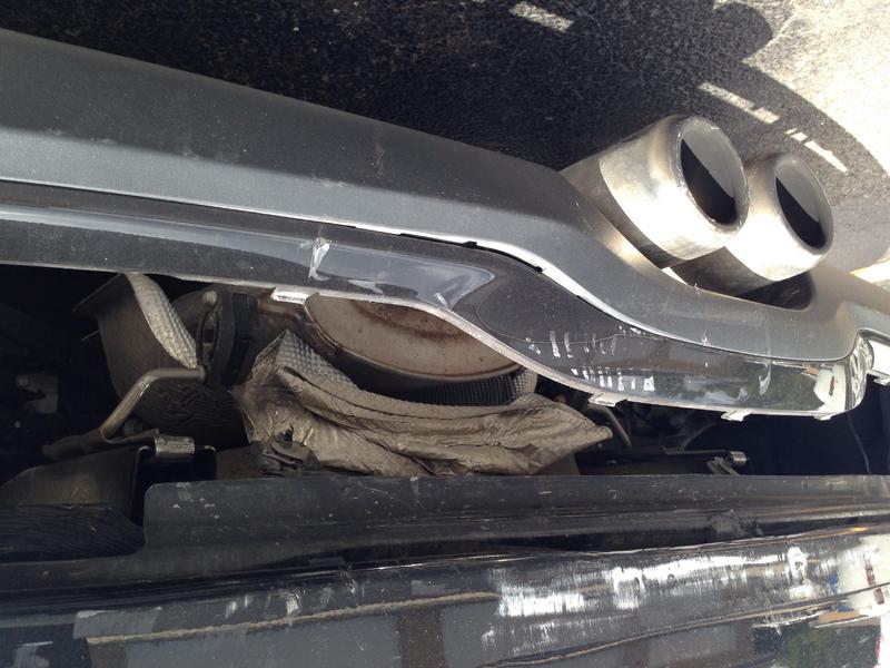

Underside

What happened?!

aww man, what rear-ended you?

Got popped by a 2012 Chevy Cruze. Traffic all stopped hard, I was able to stop without hitting the jeep in front of me, she was unable to stop without hitting me. Luckily, I didn't get pushed I to the Jeep in front of me.
Preliminary estimate is $2700, possibly more once they get it disassembled if anything else is damaged.
The good news is, it happened on Sunday, I filed claim on Monday, went to the body shop and the guy ordered the parts for me on Tuesday without even waiting to hear from her insurance (Allstate) because he's a friend of the family and he's awesome. I talked to the lady at Allstate handling the claim and she's been real nice, I have to take it to get inspected by one of their adjusters on Saturday morning and they'll cut a check to me right there. They're also paying 100% of my rental once I drop the car off for repairs.
Assuming there's no further damage, my body guy said he may be able to have it fixed for less than what they cut the check for. If that's the case, I may be able to use the excess to get two new tires in the back to match the front two I just got a week ago. (Picked up a nail in the sidewall on one of the fronts.)
