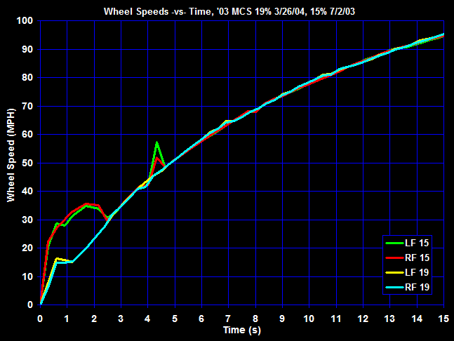

I do wonder if perhaps a LSD would not allow the 19% to show more of a gain? Especially in the short times (60' and 330' marks) as getting off the line and the 1st to 2nd shift traction should be noticeably improved and the additional low end grunt applied better.

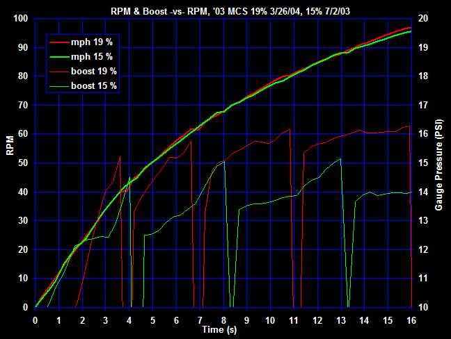

>>Here's an interesting comparison. Last July, I ran a 14.745 @ 93.61 with my 15% pulley. Here it is plotted with the 14.783 @ 93.73 that I ran last night with the 19%.
>>Considerably more boost, very similar speeds. Hmmmm ....
Is the above 15% run with the Magnaflow? If so, it's not too surprising to see the magnaflow + 15% = the one-ball + 19% since the above comparison is in the high rpm range.

I doubt the limited slip would make much difference in my dragstrip runs. Wheelspin was pretty even from side to side:

That could make a difference, but I saw similar behavior on the street with the 19% and the Magnaflow. Acceleration was much greater than the 15% at relatively low rpm, but as revs climbed, acceleration curves converged.

I believe the reason for this "closeness" is because the dragstrip only uses the upper reaches of the rev band. Other than the launch, revs never drop below about 5,000 rpm. The 19% has low end torque as its forte.
I think Andy is right on the nose with this one. Once you get out of first gear, it's all 5k RPM to redline. And the 19% and 15% only differ by a couple HP at best at the high end. So the difference is probably not that great. However, it's this reason that makes the 19% ideal for the street. First of all, most of us would agree (I think) that the MCS has decent power at high RPMs with just an intake and exhaust. The 15% pulley gives power everywhere so you still find yourself taking it to redline to go fast. But the 19% gives so much more torque that it evens out the powerband to a good degree. It adds A LOT of torque with just a little highend HP. Exactly what most of us want in the first place.

BTW, I have compared my logs from 19%, Magnaflow with 19%, One-Ball. At a given rpm, all of the logs show the same manifold pressure, within about 25 mbar (0.3 psi) of eachother. For example, at 6,000 rpm, on logs taken 4 different days with 2 different exhausts, all 4 logs show between 2025 and 2045 mbar absolute (about 14.9 - 15.2 psi gauge).
