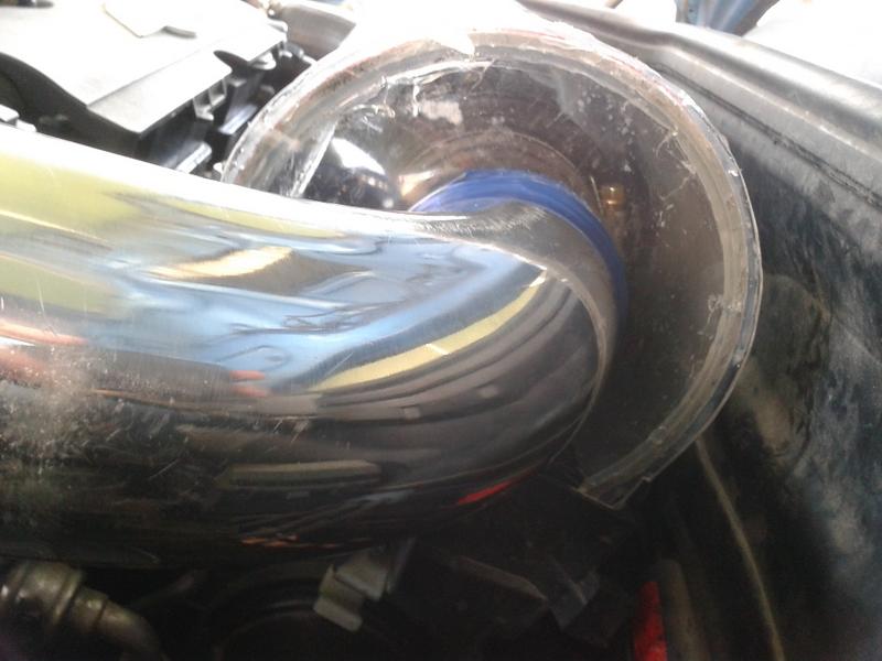

Hi guys. I just installed a K&N air filter (100mm diameter) with a CAI I made myself with some things I found at home. A 16cm PVC pipe, some plastic and a 70mm 75 degree aluminium pipe. (images 1-2). - needs some black paint and a heavy engine cleaning. It was really dusty the last few days. Like a fog of dust. Very strange for my area.
I also made some intake temperature measuring using torque for phones.
With factory filter and box, with air temp 28 Celsius the intake temperature was 31 while moving and up to 33-34 on traffic lights.
With K&N filter attached without any box (picture under), at 31 air temp, was 41 Celsius while moving and up to 46 on traffic lights (scoop half open). I must say that the driving was not good. Slow acceleration, very slow response on low rpm, the turbo valve was blowing loudly whenever you left the gas, and a lout whistle in high rpm. The filter and pipe were very hot. Couldnt touch them.
With my Box, at 30 Celsius air temp, i measured 34 degrees while driving and up to 36 on traffic lights. I didnt made a long run but the driving was like the factory filter, maybe little better, better response and you could hear the turbo valve when changing gears at 3000 + rpm not very loud. The pipe was hot. Might get better temps with some insulation

It was a cooper S airbox. Not a JCW. I removed the flat paper filter and put a cylindrical high flow K&N directly on the intake hose. Instead of leaving it as a RAM air intake and suck in the hot engine air like the Alta or the K&N typhoon kits do, I used the under part of the box and make a cover to close it in and suck the cold air from the front as the factory one does.

The intake temperatures are the same with the factory. + 3 or 4 degrees from the environment. The only difference is that the aftermarket has 1.5 times more surface area, it is directly attached to the intake tube so the bottleneck at the intake lid is eliminated, and there is more available air inside the box because now the box has 2 times the volume. It also seals perfectly on the base so it can keep pressure inside. Theoretically at least is not a bad idea and sits beside the high cost aftermarket solutions. At least is by far better idea than leaving an open filter inside the engine as a lot of people do.
As I said, i am not expecting something huge. I will be happy with little better engine respond on low rpm, or better mpg. It only costs me $60 If I could spend more, I would definitively buy the JCW intake. I am not arguing that the high end stock isn't the best

I manage to paint it, and now it looks a little better. Also i made some more testing.
a) Sound: You can hear a small whistle when you press hard the gas as it sucks air, and the valve when you leave the gas (not very loud)
b) Power: It feels little more responding. Might have little more torque at low rpm, and little more power at high RPM. Its not something big and its not worth doing it for the power gains.
c) MPG: In town i didnt see any difference. I made a trip, 60miles Highway at 42 celcius (107-108 F) at 74mph, + 40 miles mountain climb with close turns all the time and 7% slope (25 celcius), + 40 miles normal road and the average consumption was 7.2 L/100km (33mpg US) which I believe is little better. Especially with this high temps
Also I would like to say to stay away from open filters in the engine area. In high temps (>30 celcius) you will see power drop for sure.
