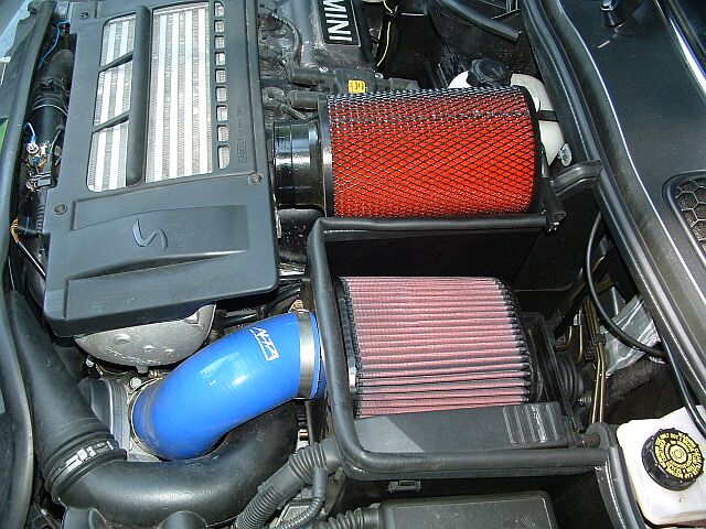

Andy's set up looks real nice as well and this is a K&N also. When my set up is complete I will hope to have reinstalled the partition (quieter) but still pull air in from the front of the filter and cowl area.

So I might win an award for resurrecting a 13 year old thread, but does anybody have any input on swapping the k&n filter onto the Alta intake like this? I like the look of this k&n and my foam filter is about done.
