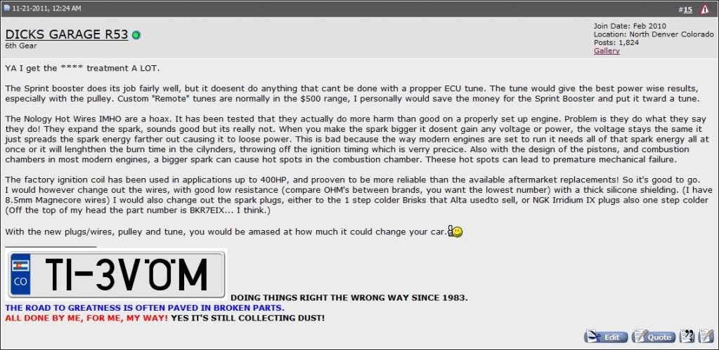

Stick with an OEM coil pack. They have prooven to be more reliable than the aftermarket units (MSD, Screamin Demon, etc.) and have been used on MINI's up to and beond 400HP.
The MSD is the worst pack, lots of documented issues concerning misfires, and total failures.
Also stick with regular low restance wires. The NOLOGY HOT WIRES also have the possibility of causing some headaches.
I did a little write up in a post somewhere on this board, about the drawbacks of different wires. I will see if I can find it and copy it over here.
