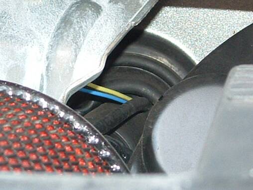

Here's a pic of mine:
I cut a small slit in it to run the wires for the coolant temp and oil pressure gauges.

Andy,
I don't think that's the steering column boot. The steering column exits way below the intake, and if you have the alta like mine it's below the intake box and cannot be seen except from under the car or by the pedals inside the car. I think that's the instrument wiring exiting behind the dash.

Ah never mind then. I thought you were referring to the wiring boot NEAR the steering column.

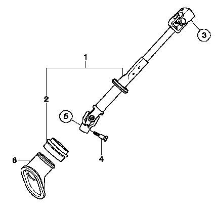

Maybe this will help?

Andy,
It's #6 on that pic. But it's how it connects to the firewall that it doesn't show. Also, #6 on my car is two pieces, it has an piece that looks like the bottom of #6 with the hole in it and then the boot that goes over it.

Ok, now I've got it figured out. What a royal pain in the &%@.... Anyway. the thin rubber I was talking about has a lip that slips around the base of the Steering column boot and then you snap the entire boot thru the fire wall. It's very awkward to do if it pops apart, especialy with one hand on your knees in the footwell around the pedals.... Guess I know what to watch for the next time I replace the front swaybar.
