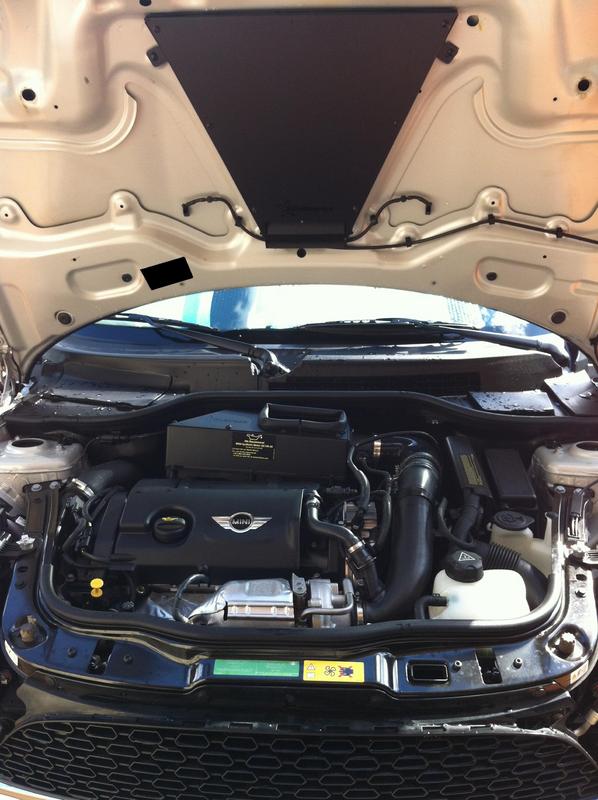

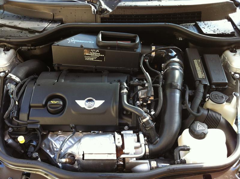

It is a 2011... Mod to the box wasn't bad and I plasti dipped all the screws and bolts so it was all flat black...

Sorry it took me a while. Work has been a !@$%&!

I may be mistaken, but it looks like your installation isn't proper. You are supposed to remove the OEM hard vacuum hose and replace it with the supplied hose. Also, it doesn't look like you rotated the line attached to the motor itself...
Just a callout - the instructions were very specific and warned not to install like you did.

The instructions are bad when it comes to 2011+ N18.. You can't rotate the vacuum fitting as it's fixed. Putting that soft vacuum line they give you is asking to die. The heat in the engine bay along with vacuum pulling on that tube collapsed it. I lost my brakes.
