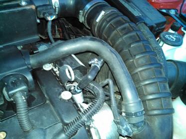

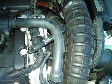

New and improved setup!
Added a 90degree fitting and a male to male to 5/16" reinforced fuel line.
Fitting is also epoxyed back together and survived the trial drive!

That's great. I really hope it holds up well. I liked everything about the DDM RIS, but I think they skimped out on the vacuum hose.
