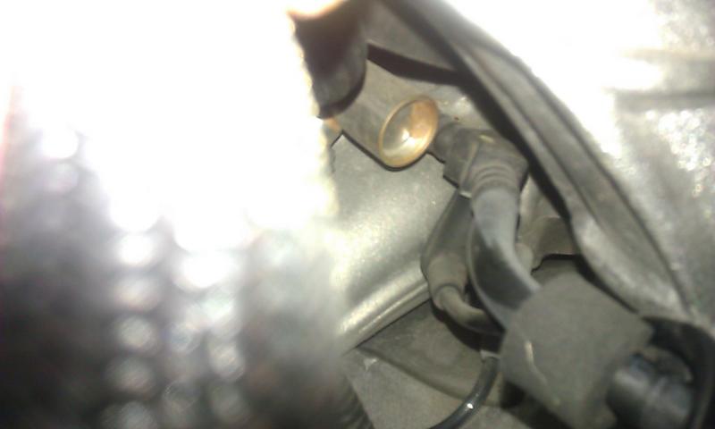

Vacuum line that is next to the fuel tank purge valve. It looks similar to the one for the FPR but it is not it is long enough to hook up to the output horn of the supercharger and it has a broken plastic piece in it like it use to go to a tee of a nipple of some sort. help please!!! its driving me nuts!

I borrowed a picture from another memeber in this forum. I circled it in red. Where does this hose connect to on the motor? is it at the same port on the air horn as the FPR? I have been getting a P1477 code and I think this is what is causing it! at least I hope it is!

I have an early 2003 MCS. I believe that there is a open port under that horn to the SC. The open port faces down. The small line in the photo with the white dot is the end of the part your pic pointed at, I think.

Perfect!!!!! I probably broke it moving the FPR one around! thank you so much! What does it supply? do you know?

Sorry, but I have no idea. Just thought it would be easy to take a pic and send.
Were you able to see what I was talking about? Hope it helps.
