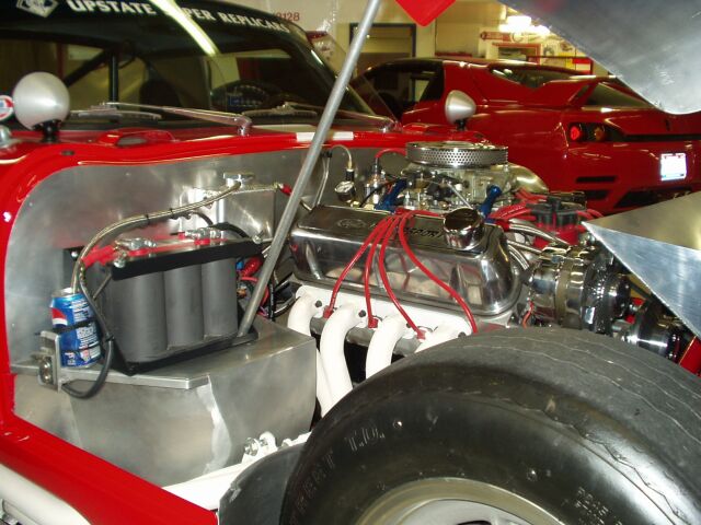

I like this catch can:
Old Jan 31, 2004 | 12:07 PM
apexer's Avatar
apexer
Joined: Aug 2003
Posts: 1,344
From: Uniontown, PA
Hope thats a clear plastic hose going into the Pepsi can and not a braided stainless line as the hose is real close to the pos. battery terminal.
