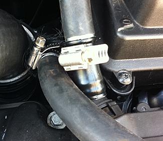

Is it like a T-connector? Any chance of a close-up photo?
Thanks!
Old May 20, 2011 | 09:23 PM
  #40
gjn25's Avatar
gjn25
Joined: Aug 2009
Posts: 165
From: Miami, FL / Palm Beach, FL
No its not a T here is the best pic I have of it now in the morning I will take a better one of it for you.
Attached Thumbnails Oil Catch Cans let me know what you think?-screen-shot-2011-05-21-at-12.19.08-am.jpg

I cut the factory hose at the other end to reduce the amount of extra hose. It takes 1 straight adapter and 1 90degree elbow. I have 90 degree elbow fittings on my can and the hoses come from beneath. I have enough room to put a second one if I want. I'll post a pic tomorrow.
I got mine from an ebay vendor. It was the only round one I could find with removable top and bottom plates, so I could baffle the insides. It has a sight glass on the side too. It came with crappy little 1/4" fittings which I replace with 5/8". I made a baffle to separate the inlet from the outlet, which also deflects the airflow into some stainless steel scouring pad to condense the vapor.
I like making things and have the ability, so all up it cost me $35 for the can, $20 for the fittings and $3 for the other bits. But I gotta say if I had some spare cash and was a little lazier, the price of this one would have won me.
