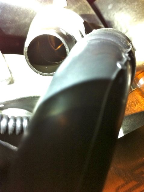

Bought the BSH for the N18 and returned it due to poor fit and then bought a 42 Draft Designs Can (simpler design, less expensive and simpler/better fit), but haven't bothered permanently mounting it yet, because when I went to do the rough fit, it didn't look like I needed it (yet). I have taken off the stock vent tube to the turbo twice now and it is still clean as a whistle. I took it off most recently last week since I figured that we're now getting into freezing overnight temperatures that now would be the time to start seeing stuff....Nothing. I do 10 mile commutes and take short trips between buildings, so you'd think my car would be a good candidate since it sometimes doesn't get to fully warm up....
Over 3K, still no OCC and the inlet to the turbo is still clean as a whistle. I can run my finger along it and get no residue of any sort on my finger
