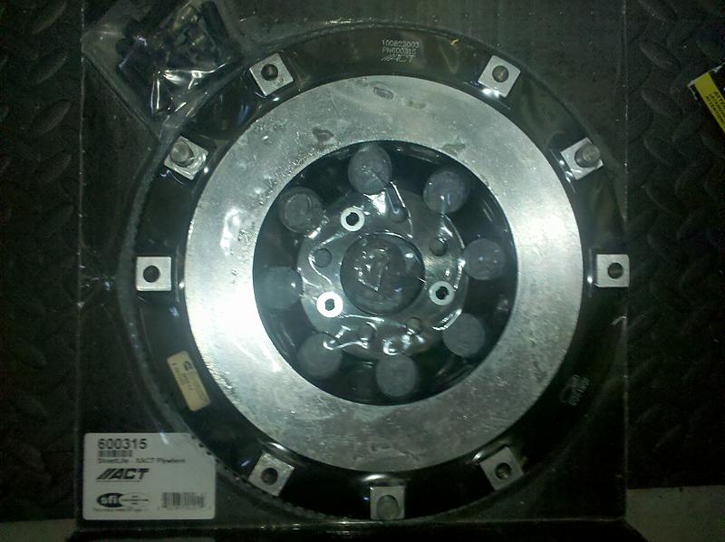

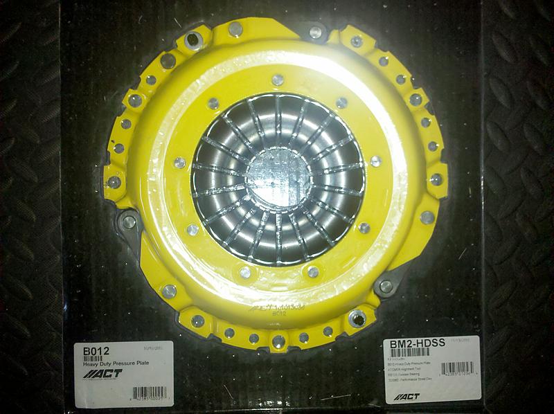

My 05 Cooper S cabrio is at the shop (a MINI/BMW specialist) getting the ACT HDSS clutch with Streetlight flywheel and a Quaife LSD installed. I wanted to start a thread of my install as there are some significant bumps in the road already and I may need some help from the NAM community!
The Quaife was purchased used with 18K miles from a fellow NAM member and was reportedly in good working order.
Pictures of the ACT components are below. I made sure the part numbers matched the manufacturer's website part numbers. For those who are familiar/bought this kit, do these look like the correct pieces?
The shop says the clutch "doesn't work" and is "making noise". They are planning to take down the tranny again to check things out. I will be charged more labor, which is understandable, if the parts are incorrect.
I did purchase and provide new 9mm x1.25 x15mm pressure plate bolts, new guide tube, and new differential bearings. However, I believe we just left the old bearings on the Quaife. Using Redline MTL fluid.
Thanks in advance!
Thanks in advance!
